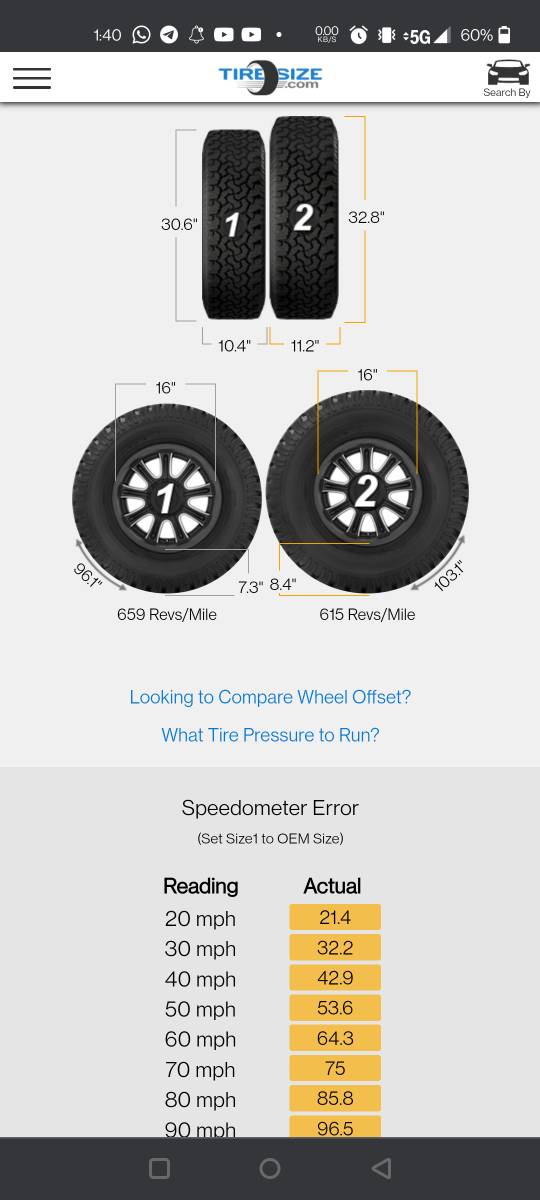

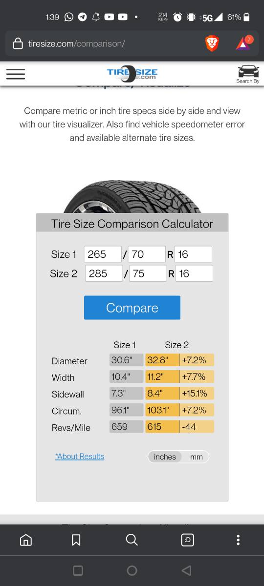

Tire Size Comparison
It's quite a bit bigger than stock. Basically a 33" tire. Unless you want to do the work for clearance you'd most likely need a lift, and even then will probably have to massage the fender liners/wheel well corners a little bit Screenshot_20210728-133956.jpgScreenshot_20210728-134013.jpg

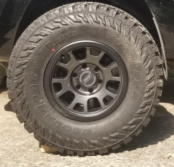

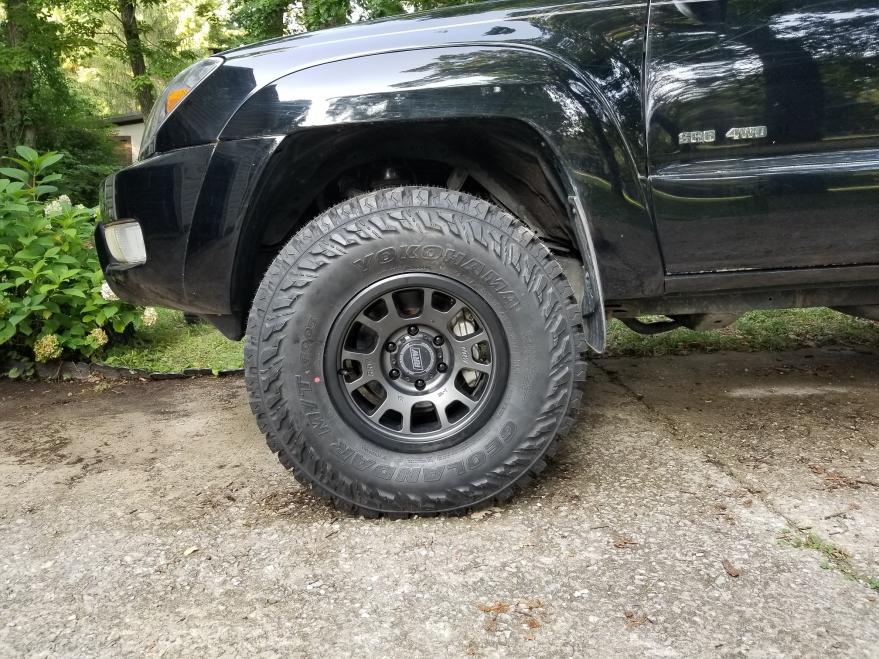

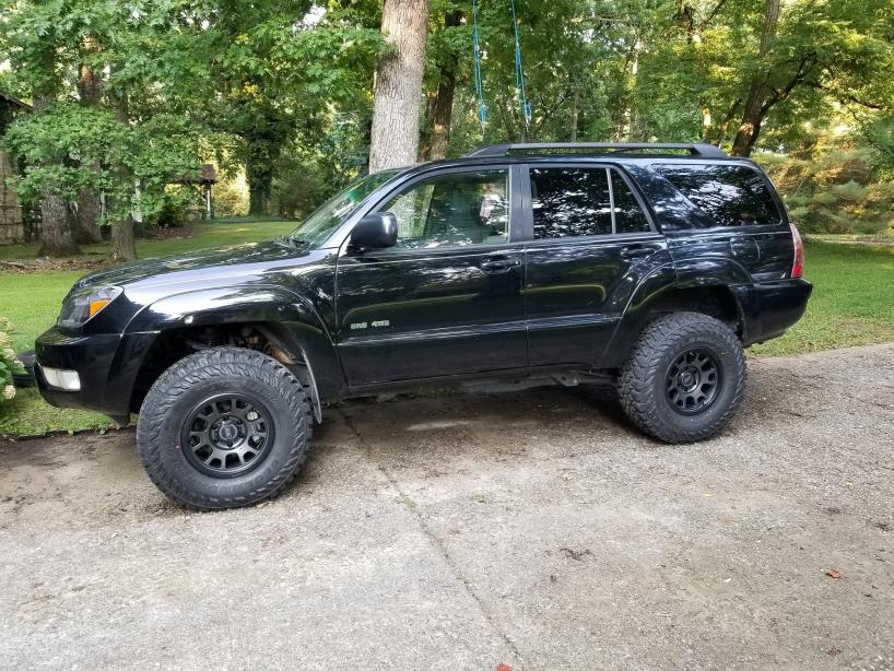

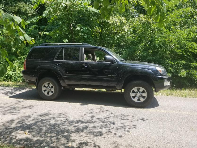

I did get the lift installed, here's a quick pic of the truck with the lift and the wheel/tire combo:
You'll be okay, lots of people run 285s without many issues. As long as its not getting stuffed all the way in the wheel well, you'll probably be fine.
Those wheels probably have enough offset for the tires to clear the UCA without spacers too, which is good
Those G003s are very good tires too

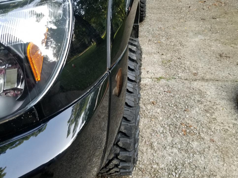

Well maybe I got lucky (buying these without knowing the backspacing, etc)...
I received the RRW Extended Lugs today, and sure enough they let me install these wheels without having to replace my wheel studs. As for the clearance, what do you guys think?
I haven't had a chance to drive it because I am replacing a caliper tomorrow and have the old one off, but I think they're gonna work!
Looks good dude!
