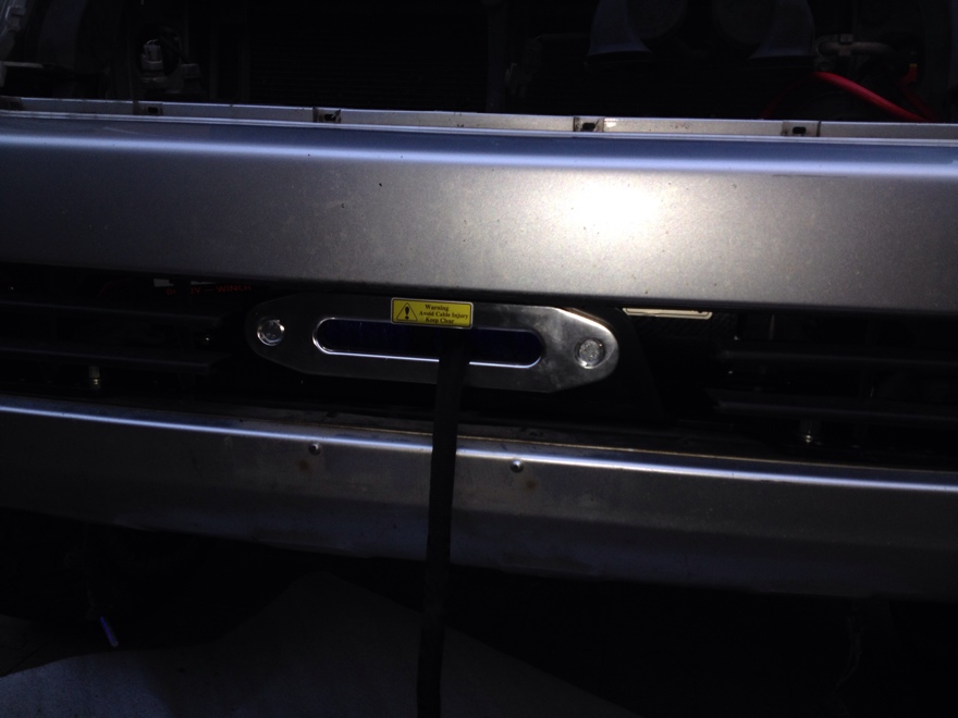

Alright guys got it all sorted out and truck is 95% finished, I ran out of daylight so will have to finish it tomorrow morning.
It’s pretty obvious I am kind of a Guiney pig for this new version and the whole thing could have been prevented by including…. Instructions… and necessary parts. Hopefully this will help anyone else with this plate and it won’t take you 20 hours like it did here to put this thing on. ;) Lots of trial and error was involved here.

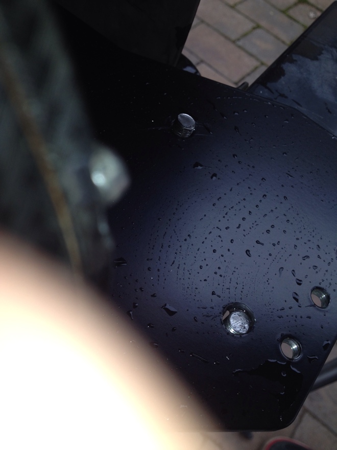

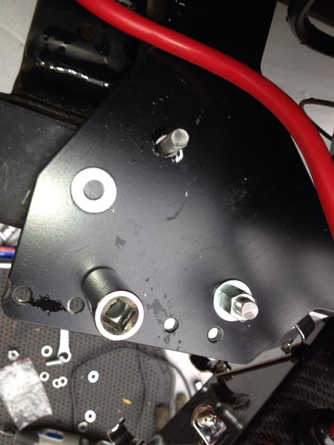

1) The 2 nuts that you need are not included with the kit, so before you start install go to a hardware store and purchase grade 8 nuts, I had to try a few different ones to make them fit, as not a lot of room there because of the L bracket. You can find the thread and pitch online for the nuts as Toyo uses same ones for all bumper support points.
2) The mounting holes for the U brackets were off on my plate, there was just no way to make it fit, hopefully I just got a dud and they are not all like this. First we took the plate off and we were going to re-drill the holes in another spot but then we measured some things and made them fit by slightly enlarging 2 of the holes, took lots of grinding/test fit/grind/measure/test fit but it’s all secured now. You can probably do this with a high speed dremil and a cutting bit.

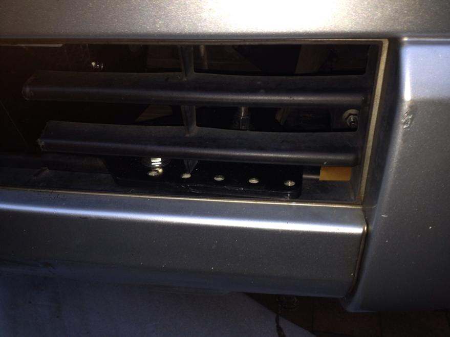

3) The bumper will not go back on unless you do some trimming in the lower black grill part, the bottom of the budplate extends past the mounting point (I don’t know why the heck the plate extends that far; looks like it’s some kind of mount for off-road lights). I attached pictures; you will have to measure and cut the lower plastic mesh legs so the plate can slide in. This also took quite some time to figure out as the plate is hidden so you can’t see where it hits the bumper when test fitting.
Truck looks great now ;)

pics 2 and 4. what are we looking at?
wow, so it was a good mistake for me to install a 5th gen. Holy smokes. either way, i would have been fine since i drilled my bolts out on the frame rails.
also the u bolts should fit if you put the winch onto the plate then bolted up the u bolt to the front bumper reinforcement and then put the winch plate and the bumper reinforcement in together as one whole unit. thats how we did it.
oh now i see it, the u bolts. those are going to fit. just bend them a little. and make them go in.
btw- we should notate what year vehicles these winch plates are going in to see if there are any model variations or year changes.
yes pictures showing by how much we enlarged the holes, it wasnt much and the nut and bolt are very tight so no issues. we did try to do the U bolts first without bolting the rest and no way they were going in, we tried a big hammer also. :tea: With these issues worked out it will be a 2 hour install job.
