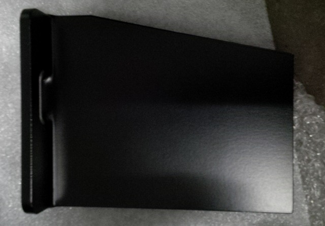

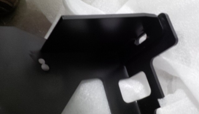

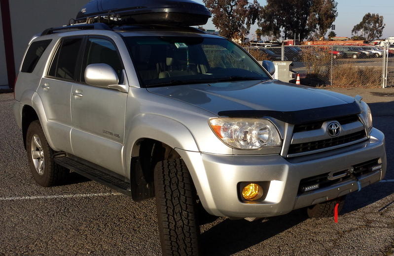

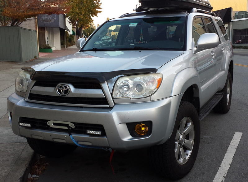

Here's a few pics from my install. First, Bud's holes were way off. I tried to give him the benefit of the doubt and follow his email instructions. Did not work. I sent two more polite emails asking to review my pics and send me a pic. He never did respond. I ended up finding U-bolts at Osh to replace the ones I stripped and then I used a dremel and a file to enlarge the inside holes.

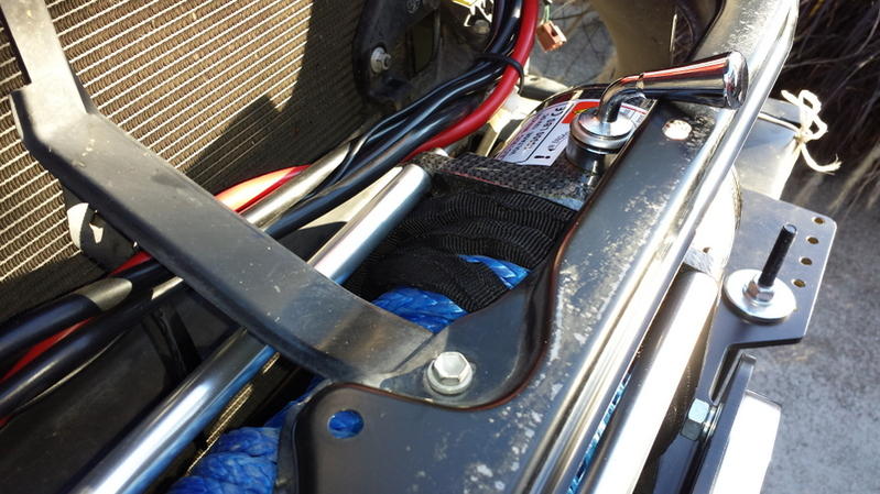

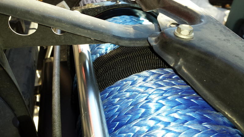

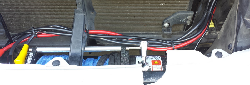

I am surprised at how tight the winch fits in the car frame! You'll see I had to cut away part of the plastic bumper to work the clutch. I'm worried about how close the rope is to the sharp edges of the car framing but I'll watch it as I use it and see how it goes.

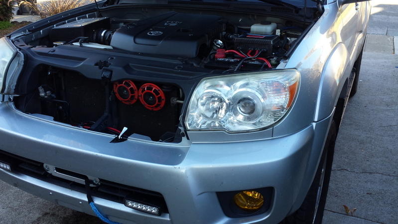

With the bumper off, it was easy to install the four new lights (yellow Winjet fogs and 6" LEDs). I had bought the light extensions from Bud but did not use them. Instead I mounted the LED's light bracket directly to the holes provided for the light extensions (using one hole on each side).

[MENTION=97688]noshortcuts[/MENTION] you couldnt clock your winch to have the clutch on the side? i chose the Warn VR10000 because it had a separate solenoid box. i was scared to run into space issues, but looks like you just made it!

I don't know what you mean by "clock your winch" but it would be nice to turn the clutch handle 45 degrees to the left and solve the problem except then it would hit the winch framing. I know it looks a bit hack but all in all not likely noticeable to others and having the powerful and quiet winch in the ready is awesome!
Clocking the winch means removing the clutch end and rotating it to an easier use position.

Totally makes sense and I wish I would have thought of the possibility.

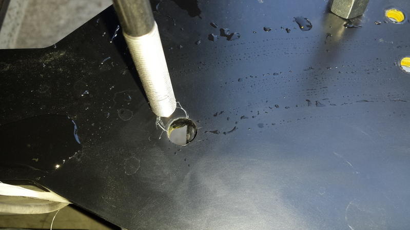

yes pictures showing by how much we enlarged the holes, it wasnt much and the nut and bolt are very tight so no issues. we did try to do the U bolts first without bolting the rest and no way they were going in, we tried a big hammer also. :tea: With these issues worked out it will be a 2 hour install job.
My holes had to be enlarged more than the pics above (for sure but don't think I took a picture of finished holes) and still the U-bolts had to twist to fit. The "big (rubber) hammer" method is how I stripped the first U-bolts.

I have an 04, my bumper is flatter across the top. Doesn't drop down like yours. My TJM is about the same profile as your Engo.
I would suggest not leaving the winch line exposed like that. Get a Daystar isolator or thimble like mine. The UV rays reak havoc on synthetic winch lines.

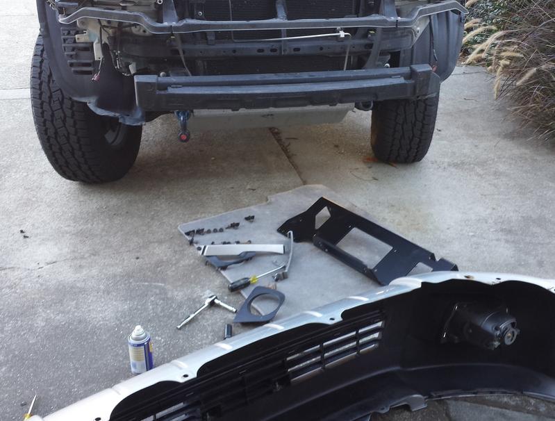

It’s pretty obvious I am kind of a Guiney pig for this new version and the whole thing could have been prevented by including…. Instructions… and necessary parts. Hopefully this will help anyone else with this plate and it won’t take you 20 hours like it did here to put this thing on. ;) Lots of trial and error was involved here.
1) The 2 nuts that you need are not included with the kit, so before you start install go to a hardware store and purchase grade 8 nuts, I had to try a few different ones to make them fit, as not a lot of room there because of the L bracket. You can find the thread and pitch online for the nuts as Toyo uses same ones for all bumper support points.
2) The mounting holes for the U brackets were off on my plate, there was just no way to make it fit, hopefully I just got a dud and they are not all like this. First we took the plate off and we were going to re-drill the holes in another spot but then we measured some things and made them fit by slightly enlarging 2 of the holes, took lots of grinding/test fit/grind/measure/test fit but it’s all secured now. You can probably do this with a high speed dremil and a cutting bit.
3) The bumper will not go back on unless you do some trimming in the lower black grill part, the bottom of the budplate extends past the mounting point (I don’t know why the heck the plate extends that far; looks like it’s some kind of mount for off-road lights). I attached pictures; you will have to measure and cut the lower plastic mesh legs so the plate can slide in. This also took quite some time to figure out as the plate is hidden so you can’t see where it hits the bumper when test fitting.

Even with the forum's insights I also took way too many hours for the install and while some was just me, the lack of instructions and incorrect tolerances of the otherwise well engineered plate didn't help!
1) On my install, the brackets proved impossible to fit with the broadside of the bracket traveling outside the bolt toward the bumper. Once flipped to have the broadside inside the bolt there are two problems. One is that the nut is trapped and harder to reach to tighten. Secondly, as you told, the short side of the bracket is too narrow for the wide nut. However, I did eventually align things to use the stock wide nuts, but it was a TIGHT fit.
2) I used a dremel and then a file to enlarge the holes for the U-bolt. Then bought very large Grade8 washers to cover the holes and capture the nut.
3) I agree that the extra material for the auxiliary light mounts is way larger than necessary (extending too far out and too wide) and complicates the install by forcing one to remove more of the stock grill. However, after I cut out the front grill to fit then the front bumper (including black cushion material) managed to slide under it.
Thanks for the tip on the line!

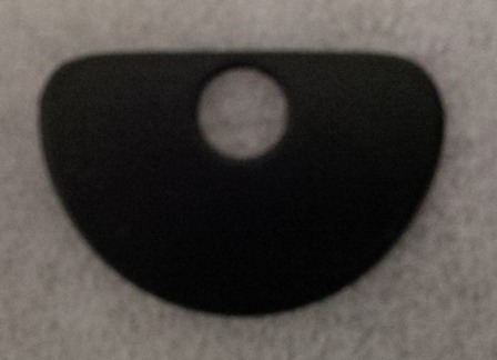

8- Then there is the weird half moon washer? I'm not sure about it, but I think it then goes over the "L" plate around the stud.
9- To recap, Bolt winch to the winch plate ( use 2 hex bolts in counter sunk holes -->put winch plate on bumper--> slide over stud-->position L Bracket-->Half moon washer -->nut around the stud -->tighten.
