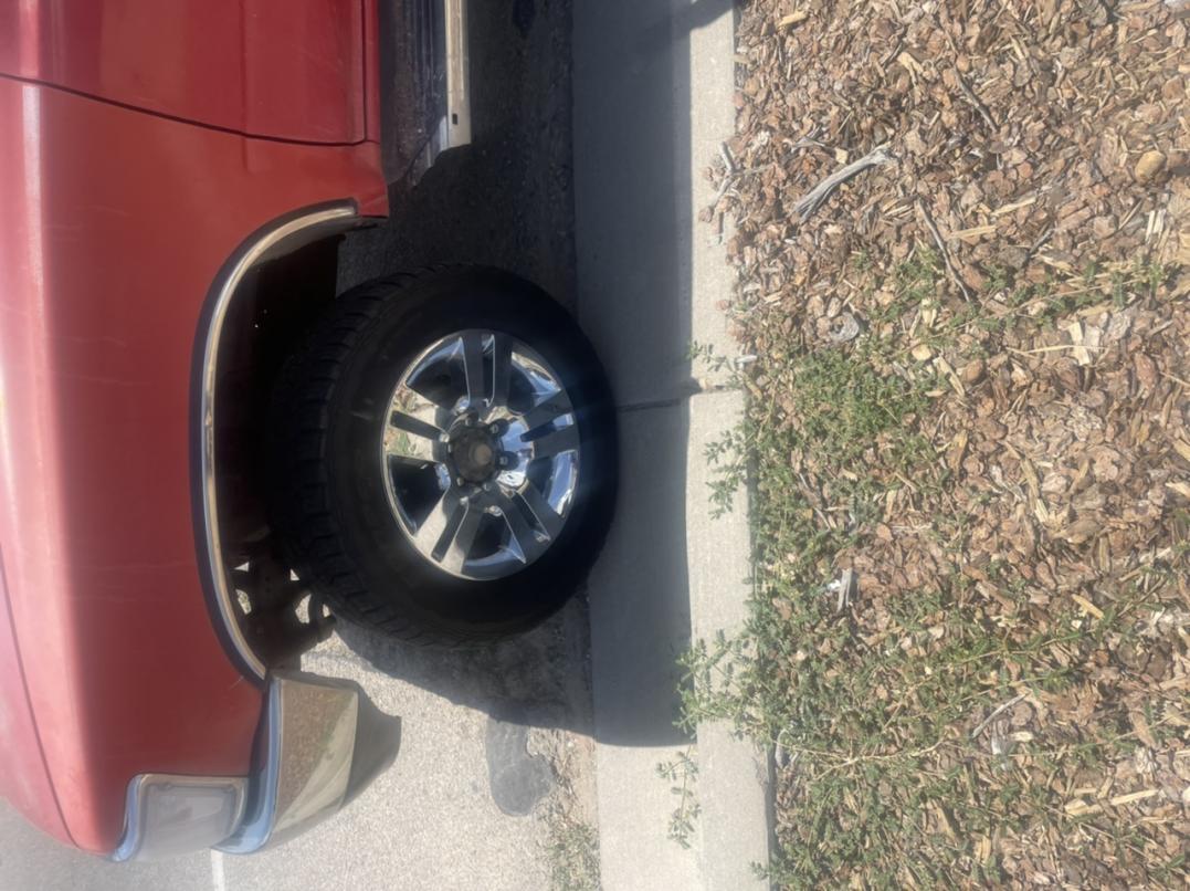

I was able to find some 18” limited Toyota wheels, they fit nice and look great, but I cant use the caps from the new wheels on the front or even the old ones on the new wheel. I’m sure I’m not the only one who has done this, but looking for solutions on front caps with the newer wheels. I have attached a photo. Any info will be greatly appreciated

when you posted this on yotatech there was no picture so I figured you had manual hubs and a straight axle since you had posted in the 84-85 folder.
Looking at your picture it looks like you either have a 2nd gen 4runner or a 3rd gen truck with ADD.
You could probably had a 1.25-1.5" spacer all the way around. That should give you the room to clear the hub with the stock limited caps

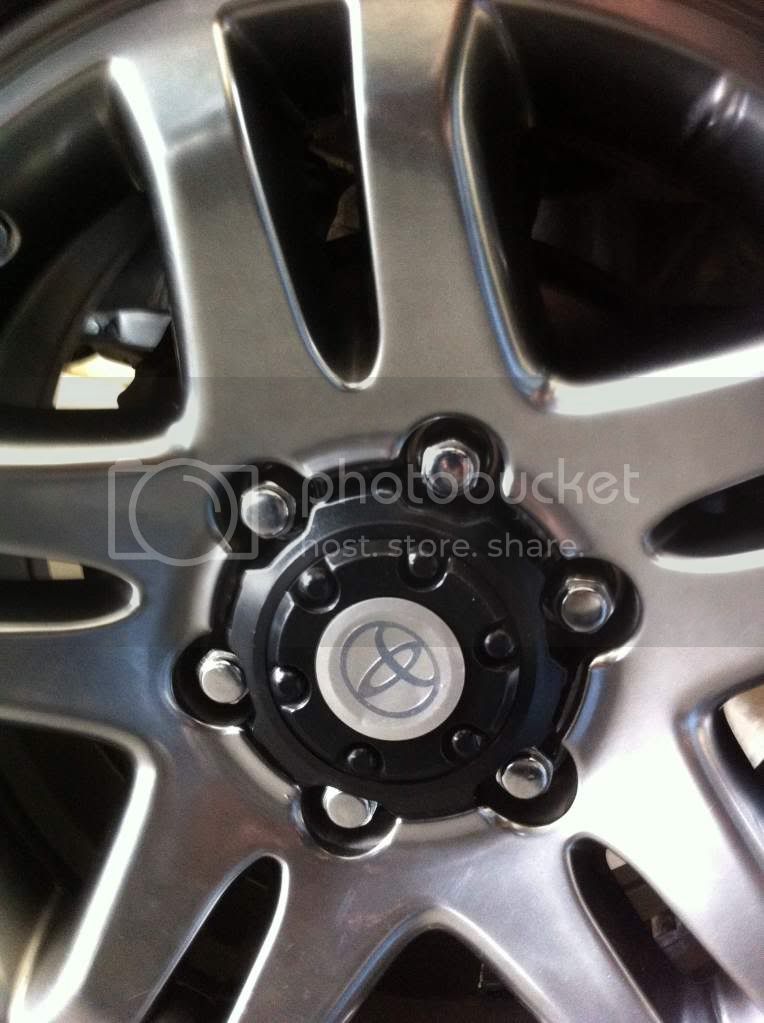

Same issue, I have a picture from 2012 on Yota tech what is needed

The picture of the center cap is from 2012 on Yotatech, long since gone member. In 18" could work for your wheel, I have to find one in 17".

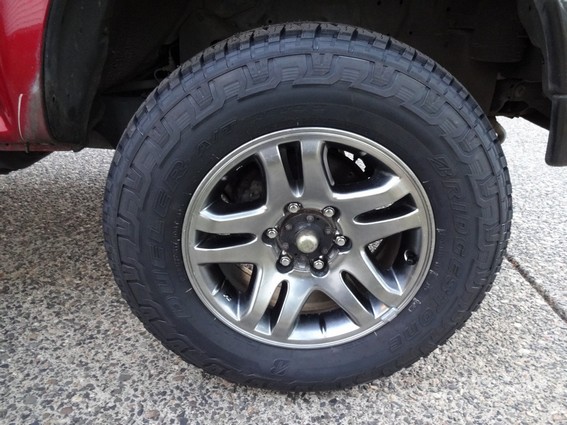

Don't want to steal the thread...
What year caps? From which model Toyo are on there? We’re spacers used?
Those black center caps are from the 1990-1995 2nd Gen runners, Tacomas' same years and some T100 trucks up to 1998 as I remember. They fit over the ADD axle, but with OEM 15" wheels. Sold those, need a cap that fits the of the Sequoia/Tundra 1st gen 17" split spoke wheel, over the dust cap and rivets. No spacers on my wheels, the Hyper Silver ones fit really well with 245/70/17s so no chance of rubbing. They are a little tall, but I like tall over rubbing plastic.
The first post is an 18" wheel from a newer 4runner, he would need the same type of raised cap that fit the prongs of his machined/chrome wheel for an 18" center hub. I see the polished metal ones online all the time, but it is the compatibility sizing that gets away from me.
