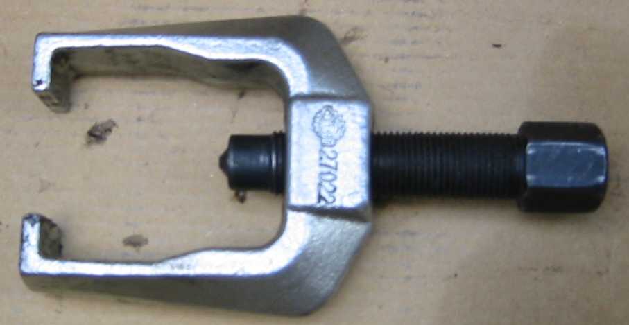

did my LBJ's and new front coils/struts yesterday. the LBJ were the easiest part. just grab a puller, and a 24mm socket, a 14mm socket, and a tourque wrench. obvioulsy jack the front end up and put some jack stands under it...
this is what I used, and worked like a champ!
