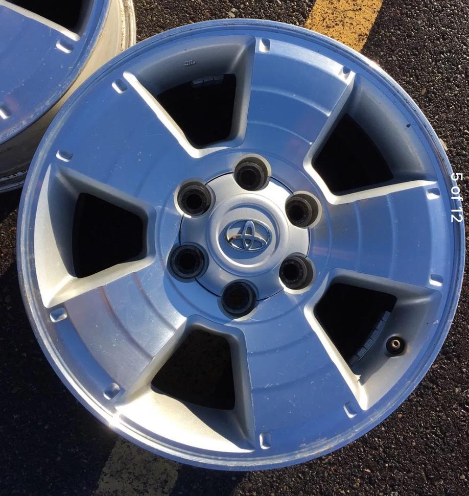

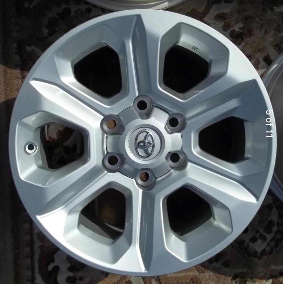

Anyone know the true offset difference (if any) between 2006 17" wheels and 2015 17" wheels?? Any help appreciated.
Like Bossman said, 15mm offset on those 2015 wheels. That translates to a little over 1/2" further out of the wheel well
I am running the17" FJ wheels which have the same 15mm as the 5th gen.
