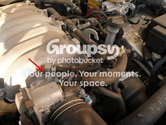

OK guys here is a pic with the V8 cover removed. So which hose do I put the Seafoam in, the large hose towards the bottom of the pic or the thinner hose towards teh top?

I vote for where I place the red arrow. To be sure pull the rubber when it's idling and you should hear a hiss and the idle should become unstable momentarily. Worst case it'll turn on the check engine light. If you do it fairly quickly it shouldn't. If you need a bigger opening the one next to it would work but it won't stay running with that one pulled.

Can anyone tell me which hose to use for the seafoam? I find it hard to believe it would be the small input with the rubber cap on it. I would think is needs to be a hose with some type of vacum..
I did the SeaFoam this afternoon in my Fuel Tank, my Crankcase, and my Intake! My Dad put a small tube from the SMALL INLET with the CAP into the can and it 'SIPPED' in a third of the can! We let it sit for five minutes and then started it up again. Not a lot of Smoke really, but then again I blew up a Celica once and that was ALOT OF SMOKE!!! So it might have been my expectations were a little off.
