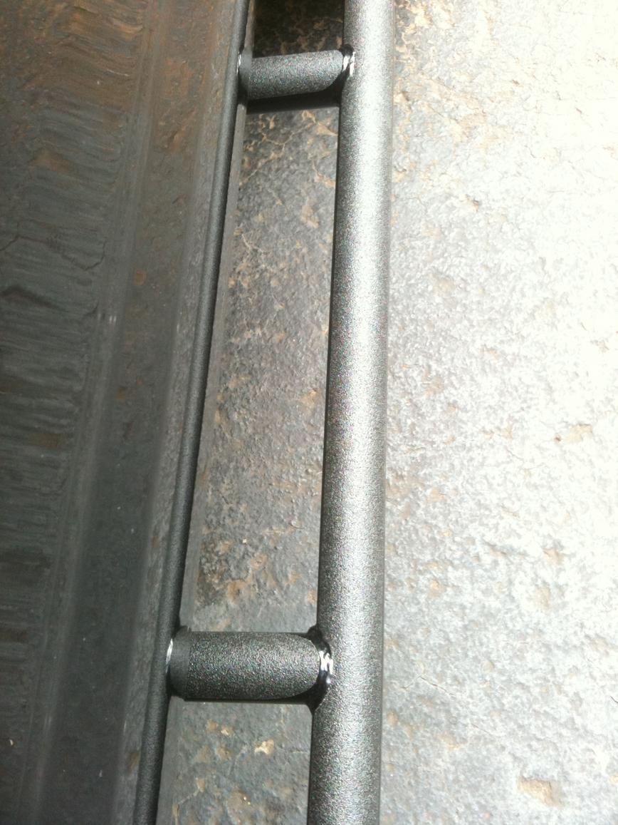

I used 2 cans each of Rustoleum Primer and "Professional High Performance Paint".
Use "strips" of cloth backed sandpaper and sand what is needed like you are shining a shoe.
then I topped each slider with Non Slip Tape which works great and is tough as nails.
Yep just ordered the same ones from summit racing only $8.00 shipping and order ed d the mounting brackets direct from Trail Gear on sale for black friday at $18.50 $29.50 after shipping. Cant wait to get them. So glad i waiting and researched a little more jump a few minutes ago. I was going to order the 58"sliders as per the websites' listing for the 4runners. 67" on the way. I plan to use the sliders as steps as well so was planningnon the grip tape same as you did. Being rock proof and added armor is just an added plus for me i wheel but dont crazy rock climb.
