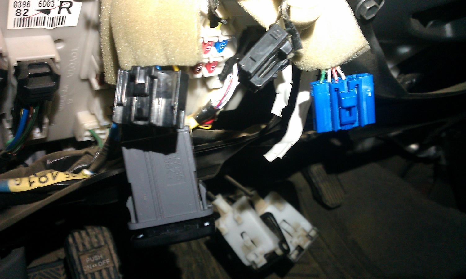

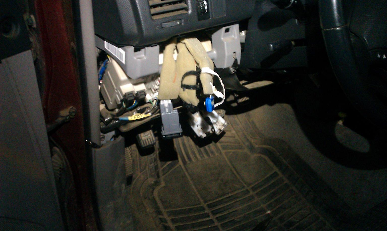

I'm ordering a trac disable button, and am wondering if anyone knows which connector goes to it. Is it the black connector, or the blue connector? or the small black one....?
Can I find this by checking resistance from the plug to the brake controller plug, or does it run through a CU?
Does anyone know what the other plugs are wired in for? Thanks for the help!

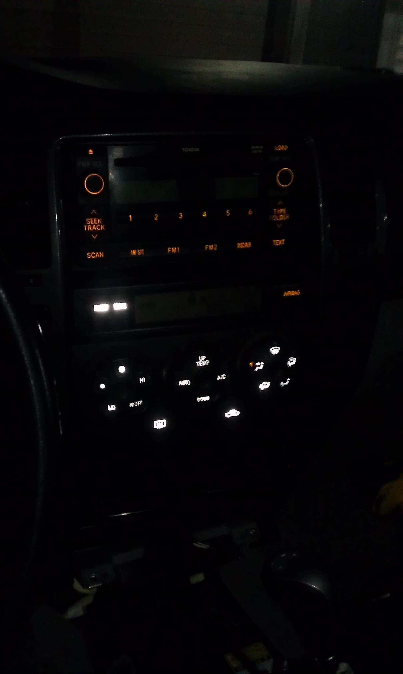

I'm also replacing the lights in the cabin with LED's.
Anyone figured out how to change the color of the instrument cluster?

what year is it? i know that the 06 v8s do not have an actual plug for VSC off. there is a thread on here that will show you how to mod it to make it trick the ECU thinking that the center diff is locked
its an 06 sport v8 all time 4wd. All I have now is a diff lock and DAC
So I read everything, and now my question is , can you isolate and switch vsc and trac independently?
Yes they are. Do yourself a favor and read the write-ups very carefully. You'll also need to buy an old switch that has the "on/off" spring in it to make the one you purchased work properly because it is a "momentary" on/off. Easy as swapping the spring. Or you could make your own.
