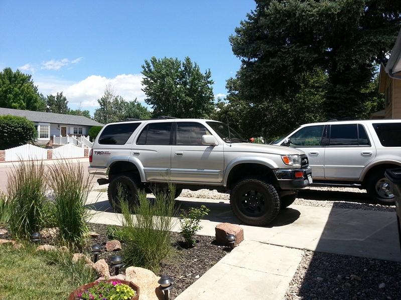

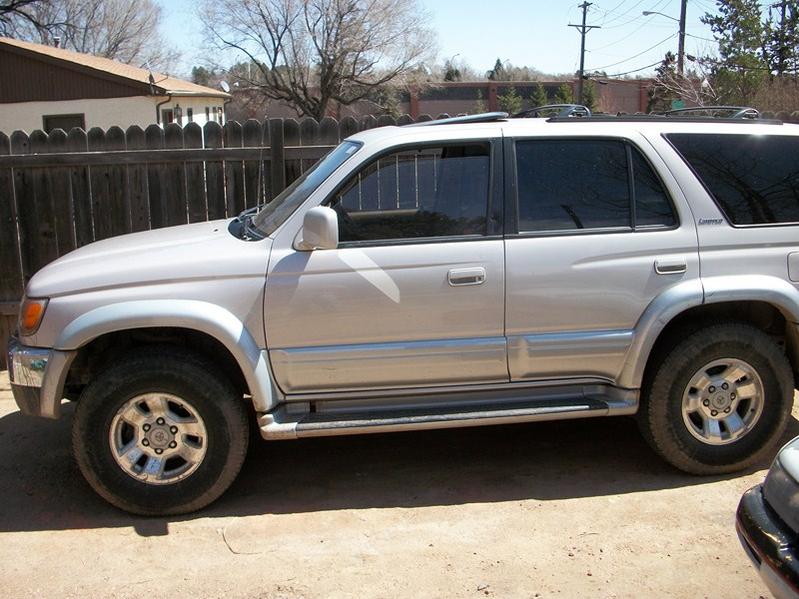

The stock back spacing toyota wheels wont move the tire out at all. Most of the 4runner 16's clear the tundras except the older split tri star type like my truck has. Here is a picture of the rims you DONT WANT TO BUY!
Before and After pics.
