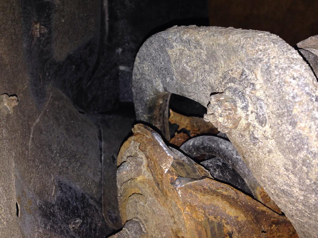

so living in nh we have pot holes galore and i hit one going about 25, and all winter my runner has been mint but once i hit that pothole its been leaning to the passanger side front BAD and there is fliud everywhere, any help on what it could be? i was thinking strut maybe idk, ill post pictures later tonight, thanks for the help.

Start by crawling under it and looking for the leak. This kind of question can not be answered without more information and/or pictures.

Well found the problem, top of shock mount tower was so rusted a chunck of the damn mount fell out when I hit a pot hole anywhere I can find a replacement that'll obviously be a weld on
