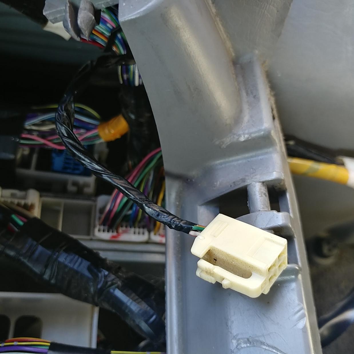

The only thing I can think of is this?.?.? I dont know what it is. Is it suppose to just hang there?
Thus is for an 04 4runner v8. That 4 pin connector is on the right side of the glove box. I can find anything that its suppose to hook up to and i dont remember unplugging it.

The connector in your picture could be for an option that your truck didn't come with, right? There should be an obvious place to plug it in.

Right side of the glove box is the ecm and that uses similar colored connectors. Not certain that's what it is, just throwing out a suggestion.
