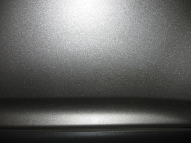

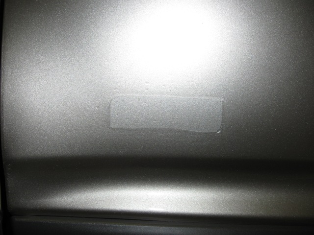

i just detagged my 4th gen and i have a problem with the driver side where i took off the sr5 emblem. it appears to be missing clearcoat. can anything fix this. the passenger side is fine though..
here is the driver side first...

It looks like the door was painted before and whoever did the work masked off the emblem instead of taking it off! If thats the case there is nothing you can do except get the door repainted or put the emblem back on! Sorry, i`m just going by the pic and over 10 years of painting cars! I could be wrong though!
i think that i might have been repainted from the previous owner :( how much to get the door re sprayed, since u paint em u might know?? or could i do it myself with some stuff from wal mart??

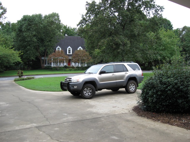

im about to take pics of it from a distance. it is really noticeable :( hopefully the elements will make it look better in a couple months.
about 40 feet away first is zoomed in the second is zommed all the way out...

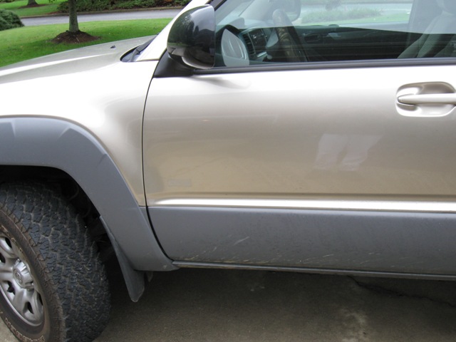

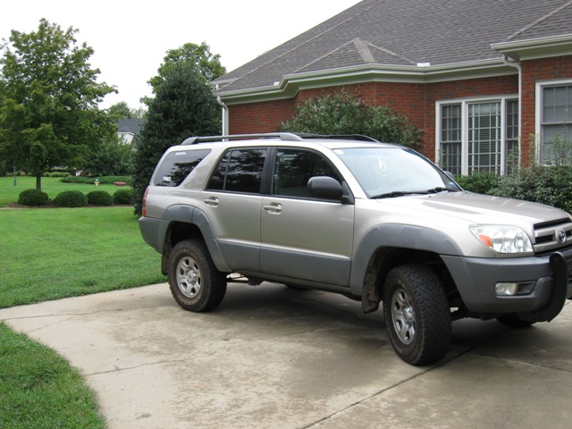

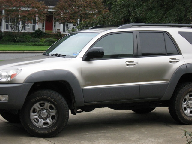

first pic is the passenger side looking good and the second is the driver side about 5 feet away at a slight angle...

I honestly couldn't give you and estimate on cost becuase labor rates vary quite a bit from region to region! My guess would be $500-$800. The main thing is if you take it to get resprayed you want them to remove all of the trim , mirror, belt moulding, door handle, cladding and fender flare, head light and front bumper! You would want them to blend the color I to the fender and reclearcoat the entire door and fender! I've sprayed 587 many many times and if the fender isn't blended I promise the color won't match! I wouldn't try and do it yourself unless you have painted before, if you use walmart paint it will look like it's paint with walmart paint! Not like the factory! Jus giving you my honest .02! I hope it helps!

well its not very bad those pics are just very close up. unless your looking at the truck straight onto the door within 30 feet u will notice it. any other angle and u cant tell.
and my friend got his jeep re painted from maaco for 199 and it looks good to me. if i ever repaint the whole thing ill do forrest green though.
