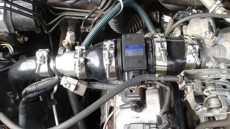

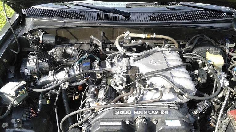

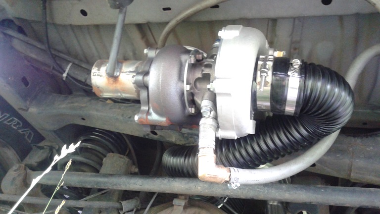

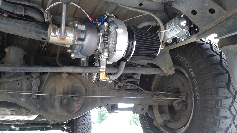

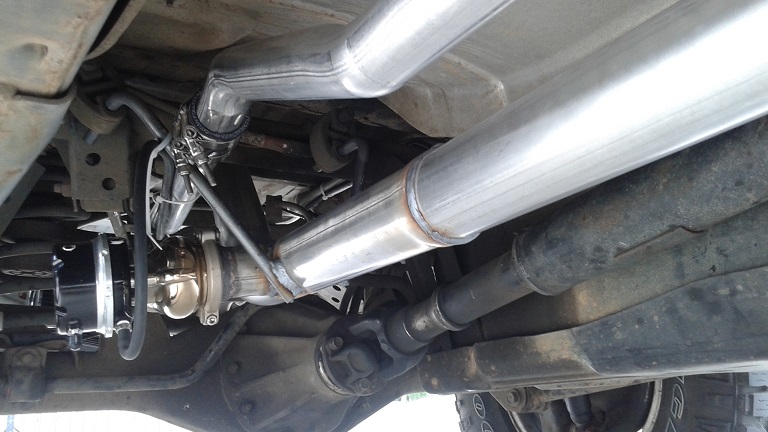

First of all, I would like to say "Big Thanks" to Clownmeat, Yoterman87, Vasinvictor, bybeed1, Robb235, flatboy and others I'm sure I'm forgetting for inspiring me to do this build.

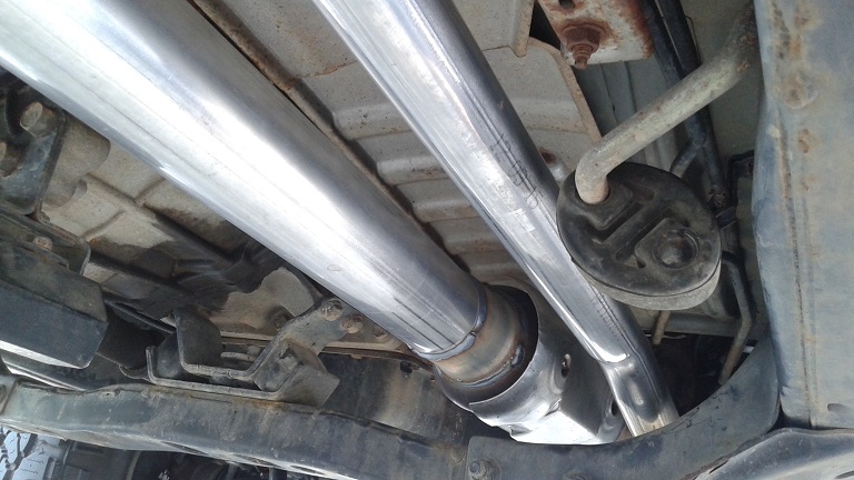

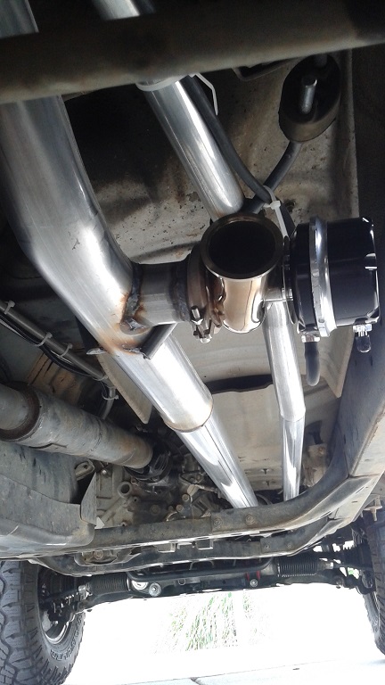

I took a little from each and a little of my own ideas and put together this RMT. I don't have or want a body lift so I found a workaround. I still have some final details to work out like changing out the oil drain fitting and hose, getting the Dynomax Ultra-Flo installed tomorrow, etc...
As soon as I fired it up, it was running great, no codes, no smoke, nothing. Idles great, runs great, feels like a new truck. Enjoy!!!

I know pictures are worth a thousand words. But I need more words!! What turbo, boost level, waste gate type, afr, fuel mods, fuel type, ems??? Going to the dyno?
I used a Shurflo 8000-643-210 ran off the Ignition "Run" side for my oil return pump. I put a timed relay on it to keep the pump running for about 35 seconds after the key is shut off to evacuate the line going back to the engine. I put a 1psi crack check valve inline at the turbo on the feed side to prevent 14feet of oil pooling back into the turbo overnight.

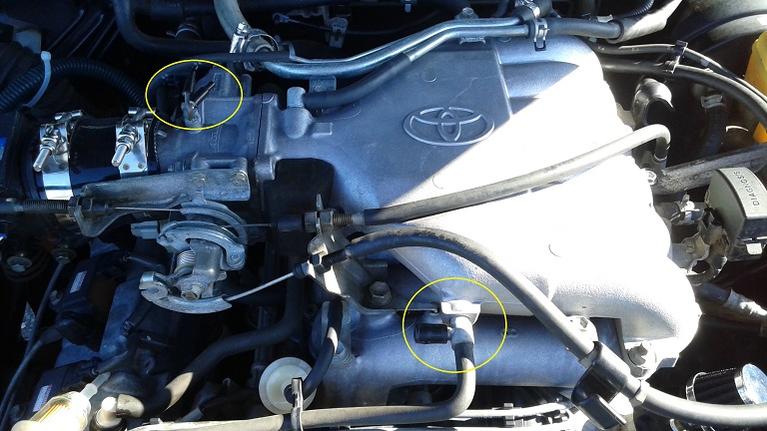

Can I hook up a boost gauge to any of these ports I've circled in yellow?
