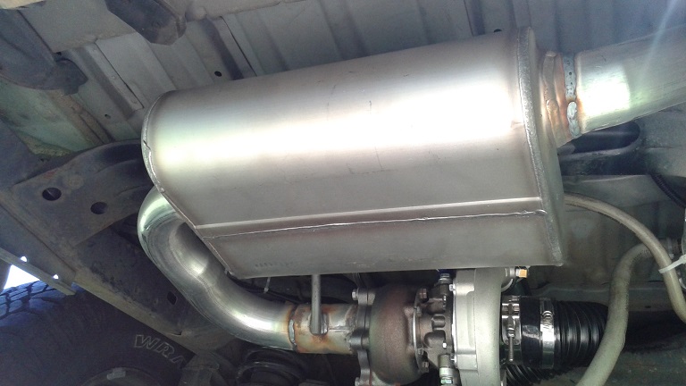

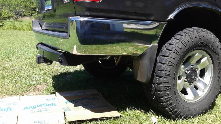

Got the Dynomax Ultra-Flo installed today. WOW!!!, what a difference. I couldn't wait another day without a muffler. It sounded like a ratty glasspacked truck with a 727 preparing for takeoff in my ear. Now it sounds mellow and quiet with a slight whistle undertone, just like it needs to be. I was concerned about using a muffler, but it's a straight through design and if it has any negative effects on boost, I can't really tell.

Hard to see from your pictures but for the charge pipe routing, how did you route it around the front tire area? Just next to the exhaust and up? Through the wheel well?
Yep, followed the exhaust up and then curved under the frame rail and up into the wheel well. It was up enough out of the way and safe even though it was under the frame.
