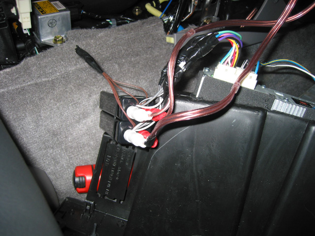

For the amp/speakers work, I brought it to a stereo place because they have done this a lot more times than me. I had done too much work on it to screw it up with the amp and speakers. They installed a line unit that converts from a cable to RCA input and that went to the amp. They tapped the signal inputs from the NAV to the amp. Now, the only reason the JBL amp is in the car is for the power inputs, ground, etc. See the pics below that might help.
Not sure why the pic didn't get attached.
Here is the pic:

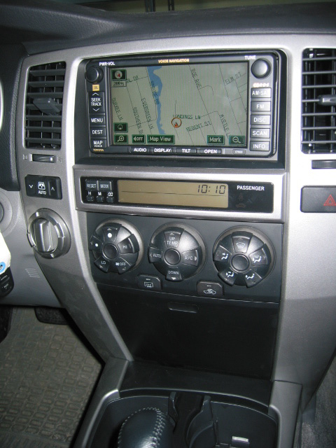

This is just what I have been looking for. I want to install the oemvalue in my '03 LTD but have been sceptical as to weather it would look professional when completed. Thanks for the great pictures and copies of the appropriate pages from the Manual to assist those, like myself, that are a bit leery about getting down and dirty.
Could you post some pictures of the finished product installed in the dash with the trim on. That would be very helpful and me to see how it looks.
One more question. T4R04LTD asked it but I did not see the response, sorry if I missed it but are you getting the voice directions and do all of the navigation and radio/CD functions operate as they should.
I live in Canada where the Navagation System is not available at this time so I need to be reassured that all functions are working before I make the plunge.
Thanks in advance.
With the connection to the speed and reverse sensor made, it functions perfectly. It recalcuates and provides voice navigation.
See pics attached.
