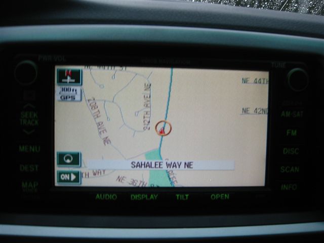

PIcs of the nav in action.

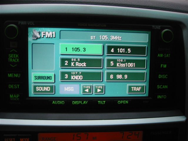

Radio function (note the surround button) And you can choose between 4 colors for these screens.

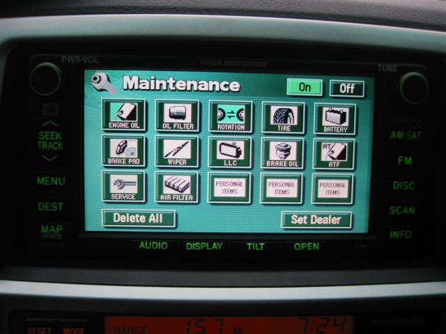

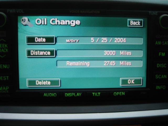

Maint. details (it tracks how many miles will you need to do maint.)
