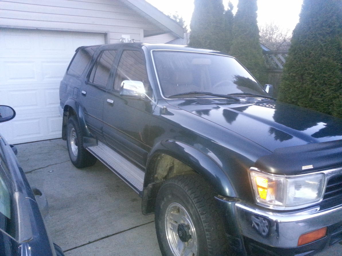

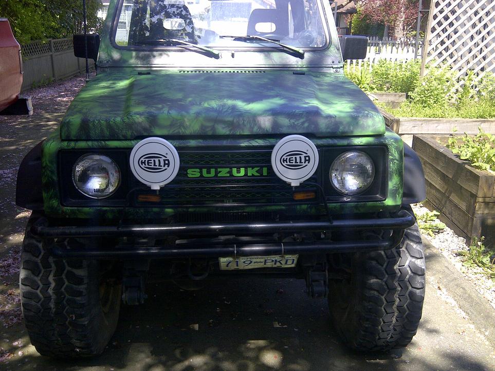

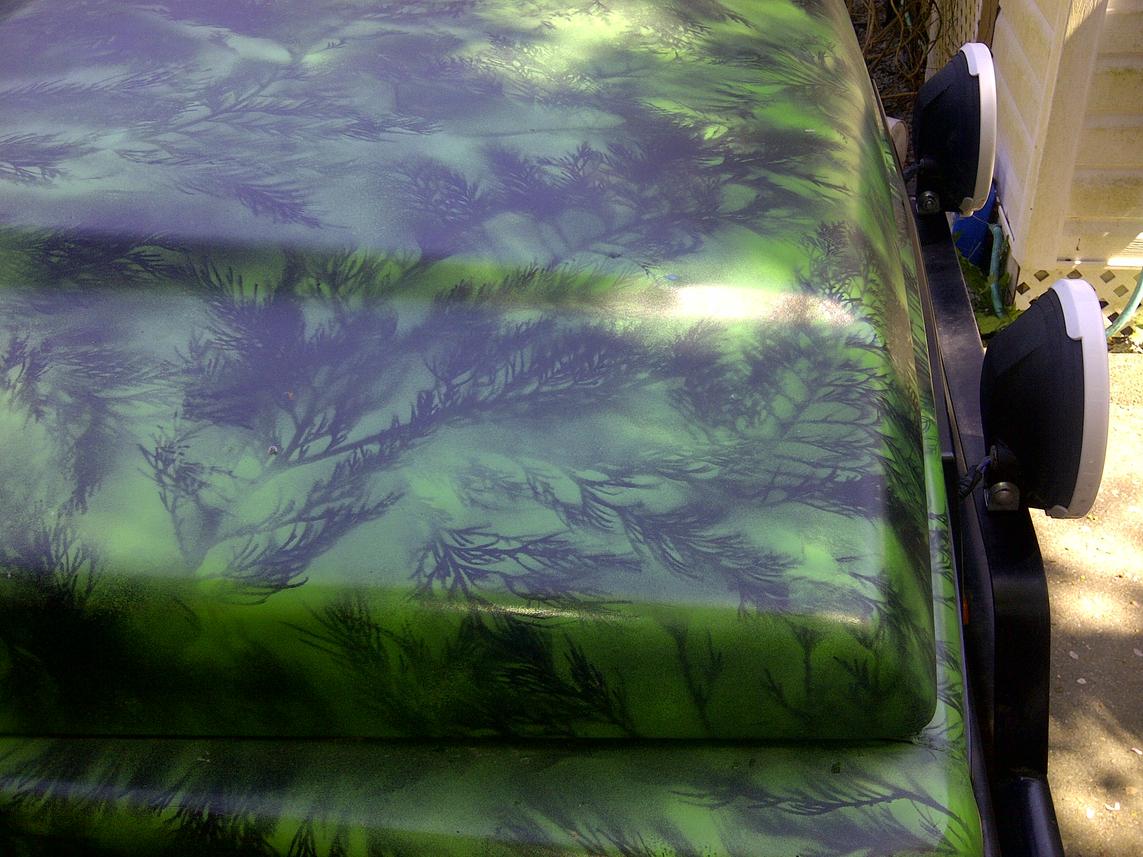

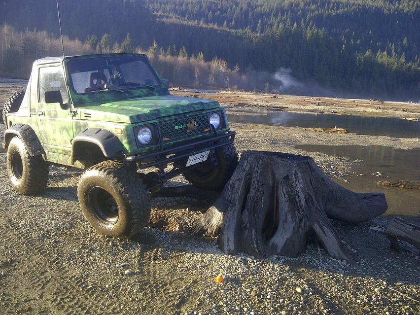

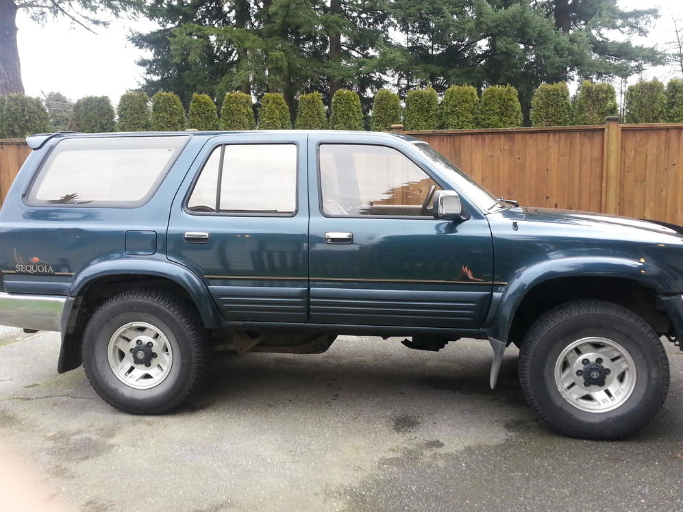

here are the pics as asked for
IMG-20120509-00112.jpghere they are all the work on the samurai was done by me including the paint took me 2 yrs . was one hell of a ride but i have always loved the 4runner and needed sumthing bigger
