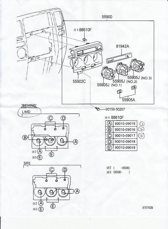

Finally changed a few of my bulbs yesterday. Would have changed them earlier if I knew how easy it was going to be. The dealer wanted to charge me $175 to get them done the last time I had my t4r in for another issue....took me 2 mins to get to the bulbs. Bulbs cost close to $5 each, but they gave me a 25% discount just for bringing the part #'s in. Here is a center console diagram with part #'s.
