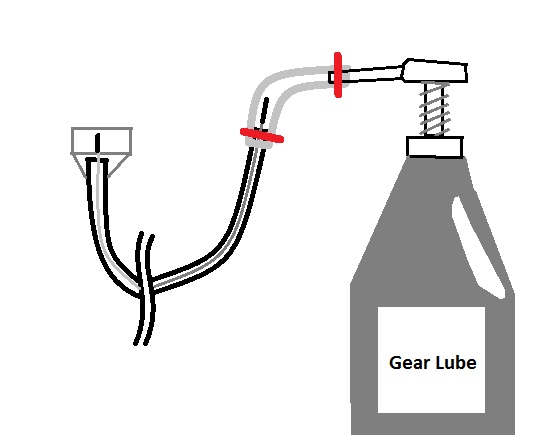

I had a similar problem with my cable, but it had slid out of the coupler on the transfer case too.
I hooked one end to my drill press and ran it on low speed.
On the other end, I zip tied some black rubber hose over the
cable cover and zip tied the other end of the hose to a bottle of gear oil with a hand pump on it.
(the kind for filling the diff quickly.)
I slowly pumped the oil into it until it oozed out the other end of the cable.
I've not had any trouble with it since then. Hope this helps
