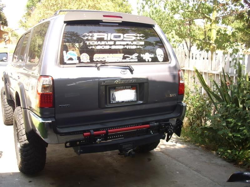

It looks good the way you have it setup.
I do think running it like that without a stock hitch would be a bad idea because when the truck comes down on a boulder or other type of ledge the high-lift jack will catch and bend the crap out of the bumper. So basically don't do it without a factory hitch.

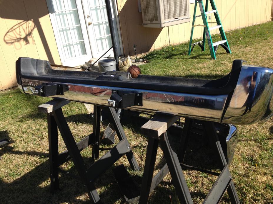

I had the 4xrac on mine and it didn't bend the bumper
found another pic
That is exactly what I would like to do. Glad to here that it worked out fine for you.
some decent bolts and some big fender washers should disperse the weight of the hi lift across the rear bumper thus reducing the chance to bend and flex. Its not like your gonna be jumping on it or pulling people out with it. It should be fine.
