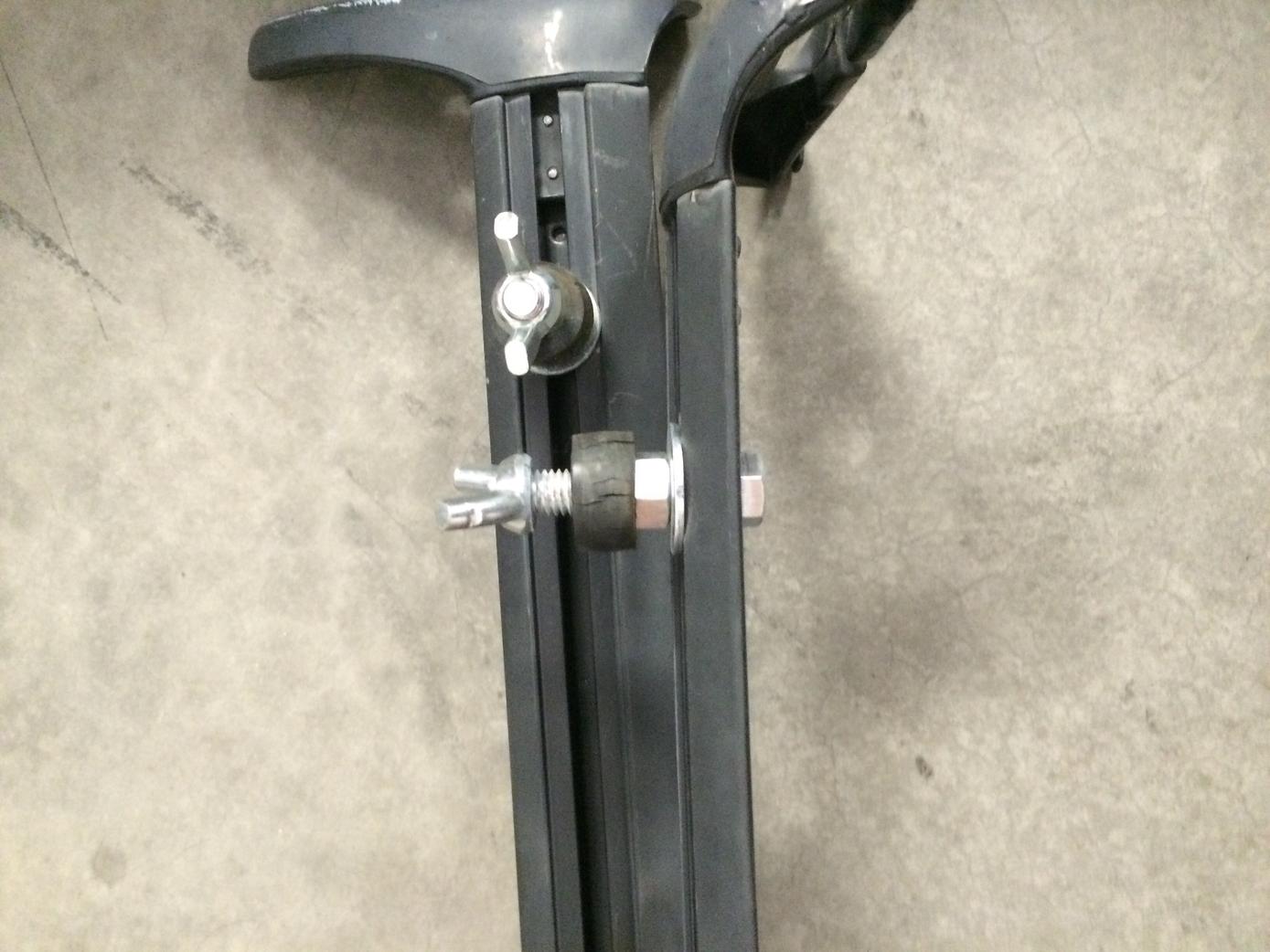

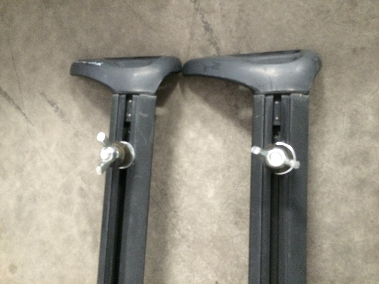

I did something similar to ARC, just used the stock cross bars and drilled. Came out pretty money, easy to access when I've needed it.
Here is what I did. I already had the Yakima mounts from when I had a kayak, so I didn't spend any extra money.
I used some old end link bushings and washers to lock everything down. I didn't use wing nuts just to help prevent theft. I know a lot of people have tools with them, but if someone wants to take this they will actually have to try a little bit.
