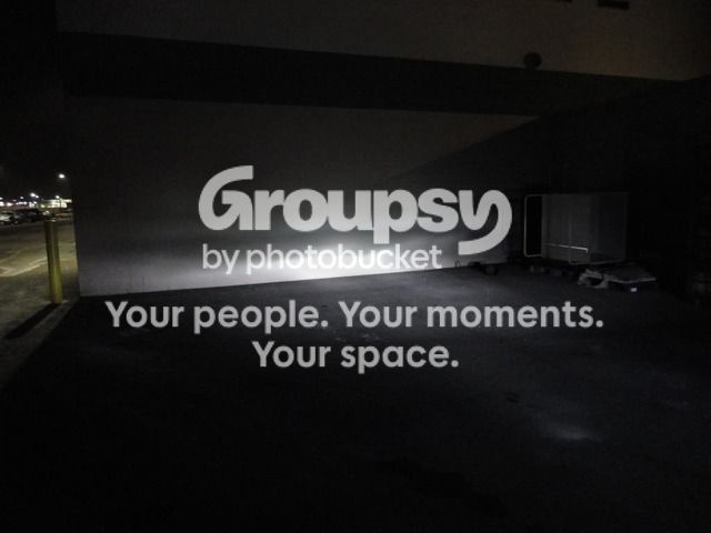

I've had both, I started with plug and play HID's from DDM and got this
004-2.jpg~original
the lighting was decent until my good conscience gave me a beat down as I was lighting the insides of peoples cars in front of me. let alone people flashing me from the front. I finally just aimed them down and it got even worse. I could only see maybe 20 feet in front of me and that was it. Scary as hell driving down a dark road. So i opted for the retrofit too and got this.
<a href="http://s51.photobucket.com/albums/f400/yeahitsgotak20/?action=view&current=installed007-1.jpg" target="_blank"><img src="http://i51.photobucket.com/albums/f400/yeahitsgotak20/installed007-1.jpg" border="0" alt="Photobucket"></a>
here is video i took driving with both sets of lights good luck man!
