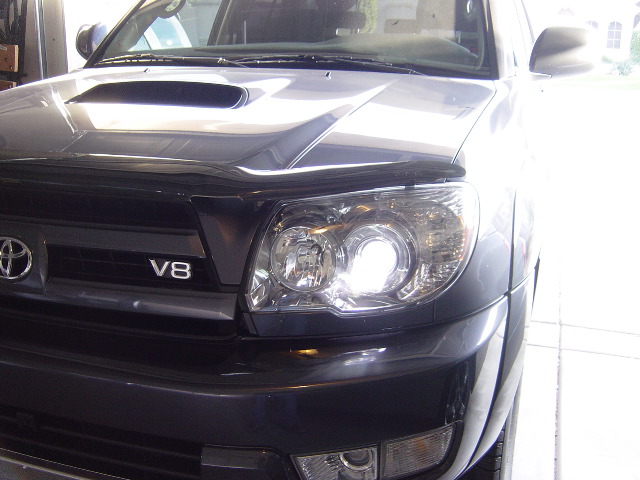

Anyway, if you decide to go with OEM '06 projectors, be aware you will be the bottom garish for it to look proper (garish: little piece of metal fills in the space btwn the headlight/grill/bumper). Even when properly installed, there will be a space See Here: (I personally think it looks fine, but some don't care for the space)
B/c your runner is white, the space between where the grill/headlight/bumper meet will be more noticeable. Also, with the costs involved, people just say, "screw it, with that kind of money, I'll just do the retros". On the thread:
http://www.toyota-4runner.org/4th-gen-t4rs/15459-projector-head-lamps-3.html#post138177 , you will find the part numbers you will need. Good luck!
