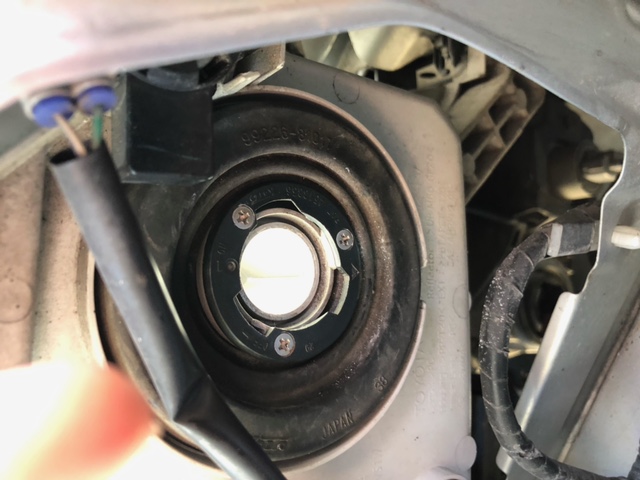

Have never really messed with HID before, except on the motorcycles i've had, took a picture of whats currently installed. but anyway, my issue.

That is 1000000% not an HID installed now. It's a drop in LED unit.

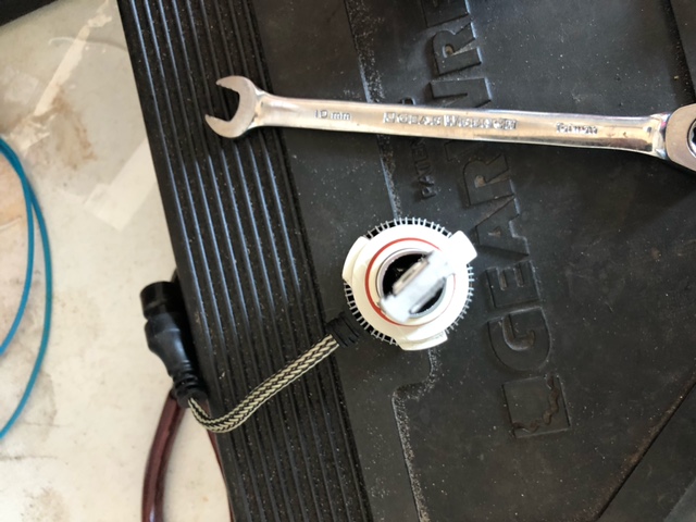

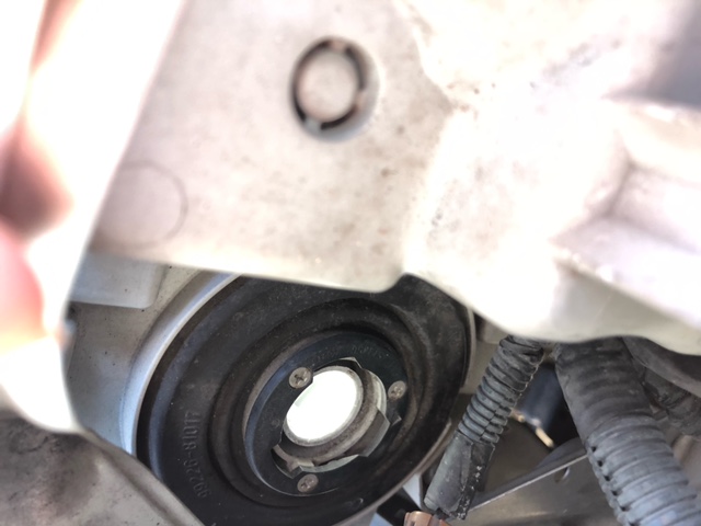

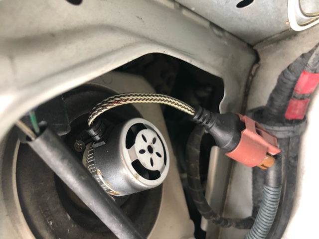

so i ordered the h11 as suggested and they don't fit into the housing, seems like the adaptor part is too small for the thread part of the housing. i took pictures of the housing and what i took out.

Can you take and post up a closeup of the actual opening for the bulb in the housing? I may be wrong, but it looks to me like somebody opened up the factory opening with a Dremel tool or something similar. That would be very bad if it's true.
Can you take a side by side photo of the bulb & cutouts in the bulb hole?
Alternatively, have you tried all 3 potential positions for the bulb? There's going to be a single position where all 3 tabs fit and it's definitely a little snug, then requires a push and twist to lock in.
If yours are like the set I just installed, I think the bulb socket had to go in around 4:00 and then rotated down to 6:00 to lock.
that looks like a 9006 housing, not the h11, so I would assume, as mentioned above, that you're the early model 4th gen.
