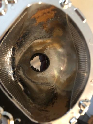

To be honest few of you guys kept saying the projectors were burnt but no visible evidence unless I removed the whole headlight out.
In the end I think my projectors were burnt before the HIDs and got worse. Wife drove the car daily never turned the headlight off. They stayed on all the time when driving.

Yup, your reflectors are shot and that would explain at least part of your problem.

Here’s an update. So I replaced the passenger projector with GR5 bi xenon projector. Night and day difference, had to modify the mount bracket a lot to make them fit, at least until proper brackets come in.
Here is what the passenger projector looked like. I think worse that the borescope shown
Unfortunately, this was my problem from the start. Even before HID’s.
