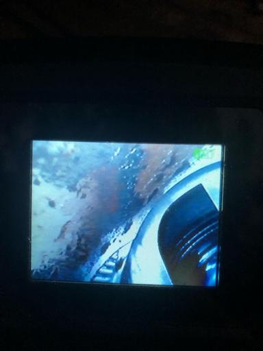

Ok here is another update and more question. I checked the projectors with my borescope. The metal in the inside of the projector on the bulb side is indeed torched. More on the passenger side than the drivers side. Driver side is a little better but still slightly charred at a single spot.
So at this point I either replace the projectors or do the whole headlight assembly, both sides.
Also how much reflective material is in the projector at the bulb side?
Here is the passenger side
That is not a piston, that is the inside roof of the projector.
