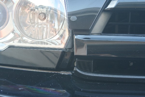

Yeah, for a decent HID setup that's what you'd need but you'll also need the under-the-light trim which goes for about $28 per side I believe. If you don't get the trim you won't be able to reuse your '03 trim, and it's gonna look pretty crappy with no trim pieces.

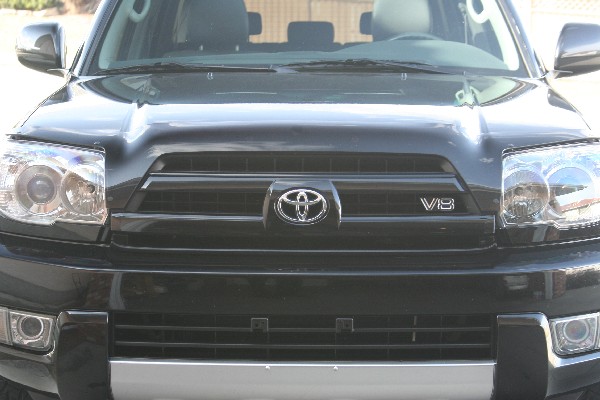

Yep! That's it. B/C your is a pre-2006 model, you need the 2006 projectors WITH the bottom garish (thin piece of trim under the lights). You will have a small gap btwn the lights and grille, but it isn't too bad. check out pic:
