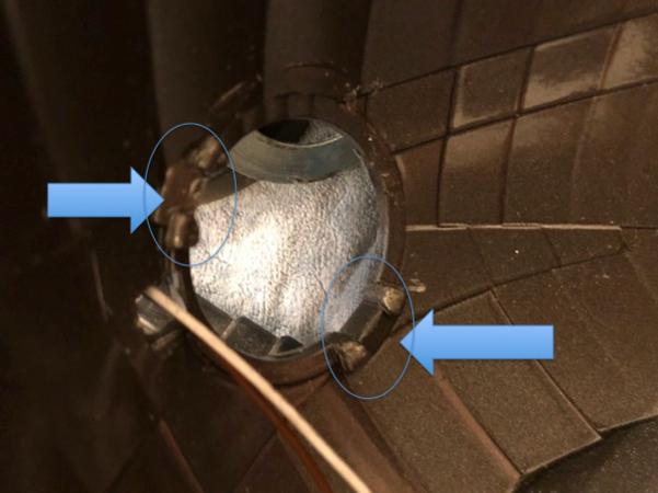

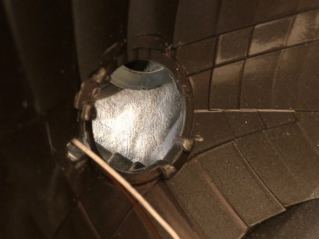

I had an issue where I finally got to fixing it over the weekend. My cutoff came turned clockwise about 10 degrees and was not parallel to the ground.
When I cracked opened the glass cover, the culprit were these two knobs that acted like a pivot and twisted the lens and the cutoff.
Solution, I trimmed the silicone gasket where it meets the knobs or shave these knobs off. I did the first option and that solved the issue.
Also, it's little cumbersome, but test fit it on the car before you enclose the glass cover.

- what knobs, exactly? I looked at your picture and it isn't obvious to me.

I drew on the pic (see attached)
