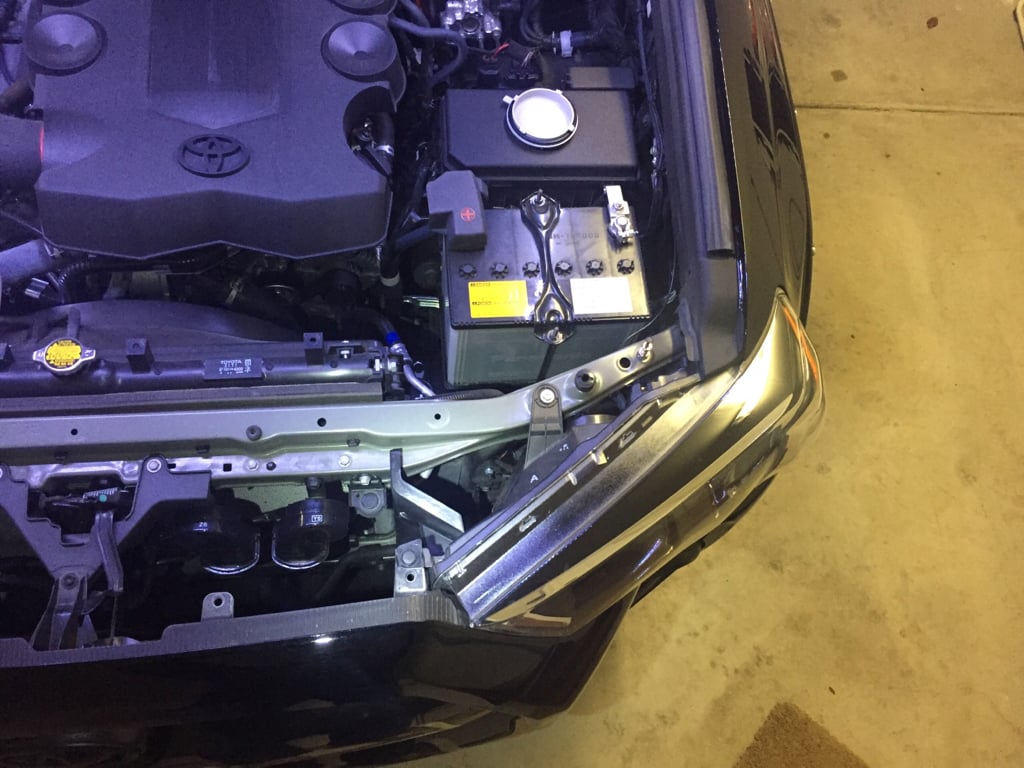

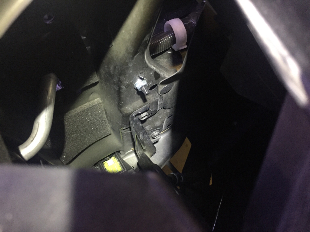

Just installed the TRS Morimoto Elite kit. No issues so far. All the install tips on this forum and thread are great. I himmed and hawed about where to place my ballasts. I almost went with this location in the area behind the grill but in front of the radiator. I was tempted because it looked like two existing bolts would line up perfectly with the ballast bracket. However, it appeared to receive much more splash than the locations that [MENTION=103267]Saker[/MENTION] used. I ended up installing them and the relay in exactly the same place as [MENTION=103267]Saker[/MENTION]. Guess I just can't stop copying him! The pics should go in order from zoomed out to zoomed in.

[MENTION=137357]roozter[/MENTION],
I know it took a little extra work placing them there, but I think they are tucked away nicely and make for a clean install!
