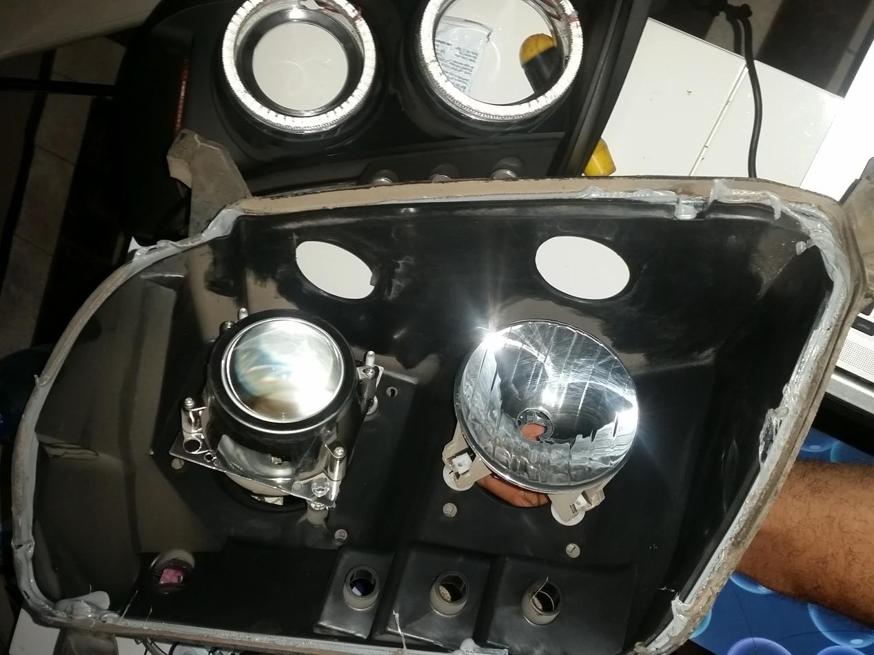

If you know how to work with dremel - just re-trofit the set. 03-05 headlights are so easy to work with! You can mount literally any OEM projector with minimum modifications if you handy, halos or LED strip (which I plan to add next). When it comes to on-road lighting performance, nothing comes close to high-end OEM projectors. You will be disappointed with output and quality of headlights in your link.

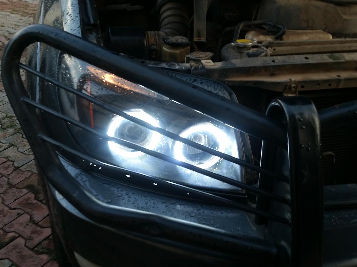

How is the light output quality? Decent? Far better than stock I'm sure...

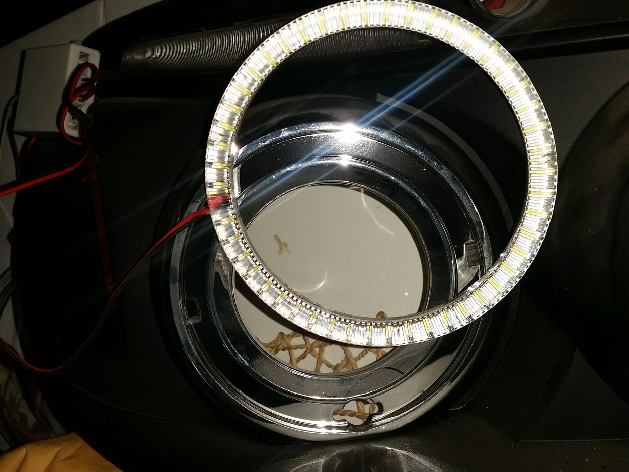

not sure which is better, guess the hid is about 20% better, my main gripe is the halos are not bright!...allmost invisible in daylight,
i intend to open it up and install the superbright halos i bought from lightwurkz

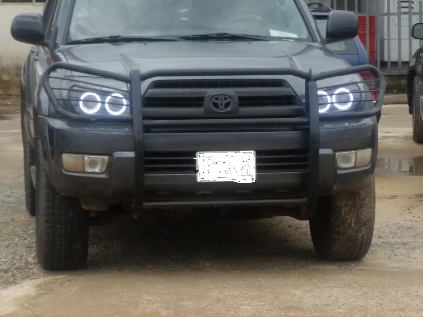

You're running the OP's xenon-types, correct?

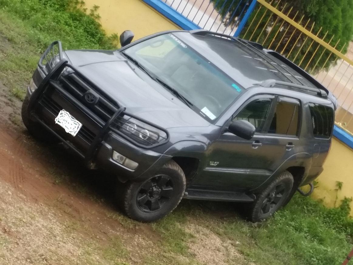

so attached are the pictures

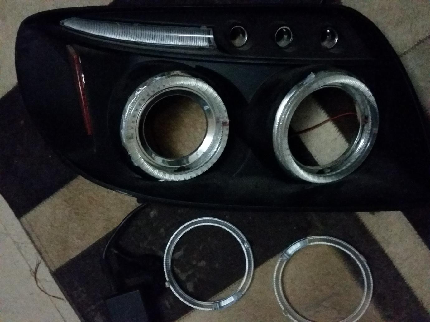

Sorry to bump an old thread, just curious if anyone has tried fitting new projectors into these Spec D headlights?
Bought a pair and have been running them for a year, and now all of a sudden the driver low beam projector crapped out on me. Thought it was the H1 bulb, so I switched the low and high beam bulbs, and that did nothing. So now I’m stuck between buying new housings, and doing a retrofit, or seeing if I can make a new projector fit into these current ones (something that is good quality).
