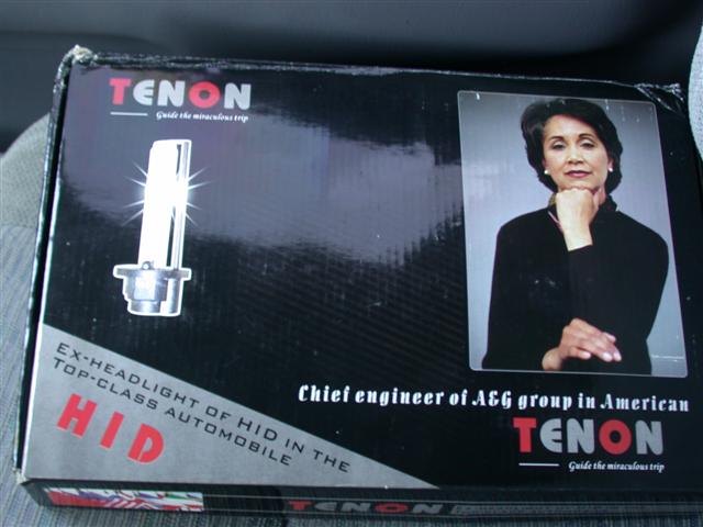

heres the box, i have to get them aimed today:
