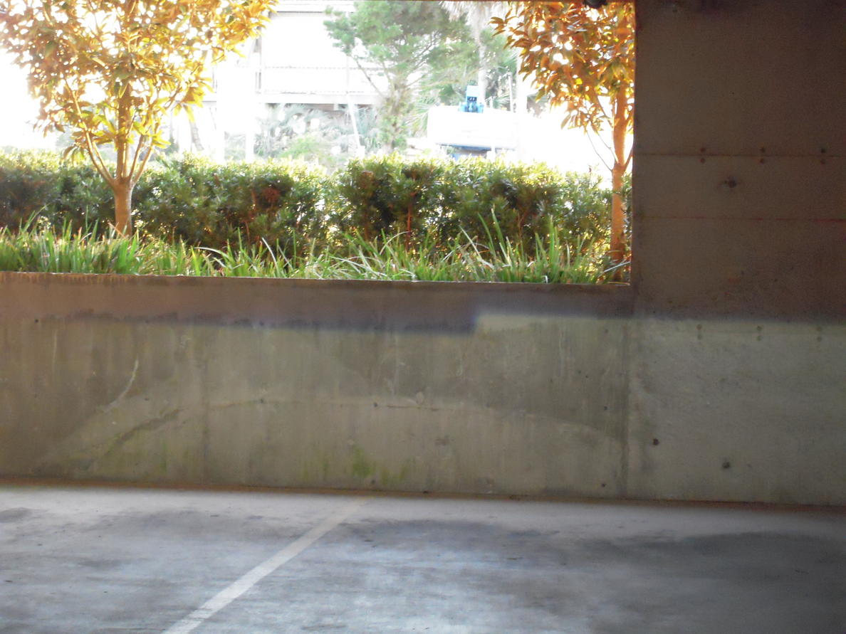

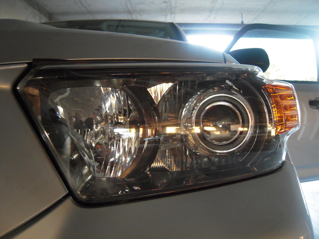

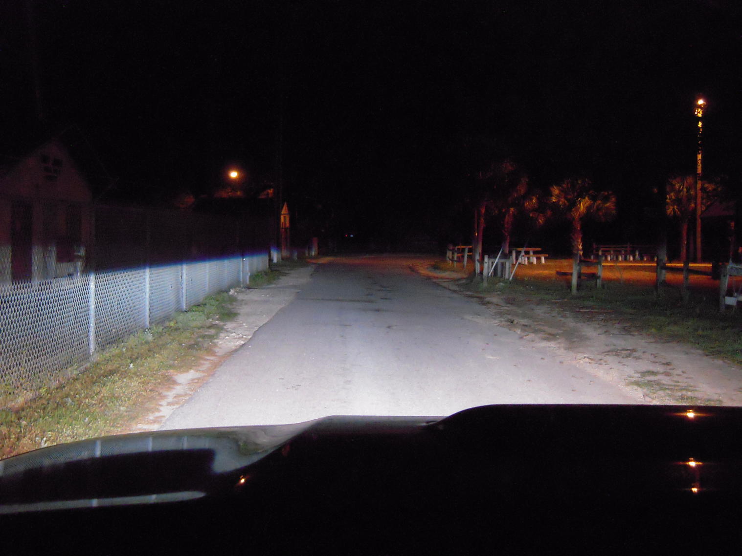

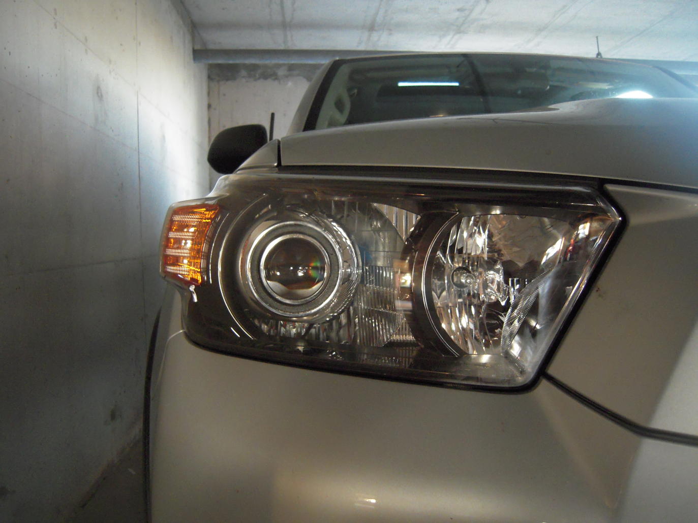

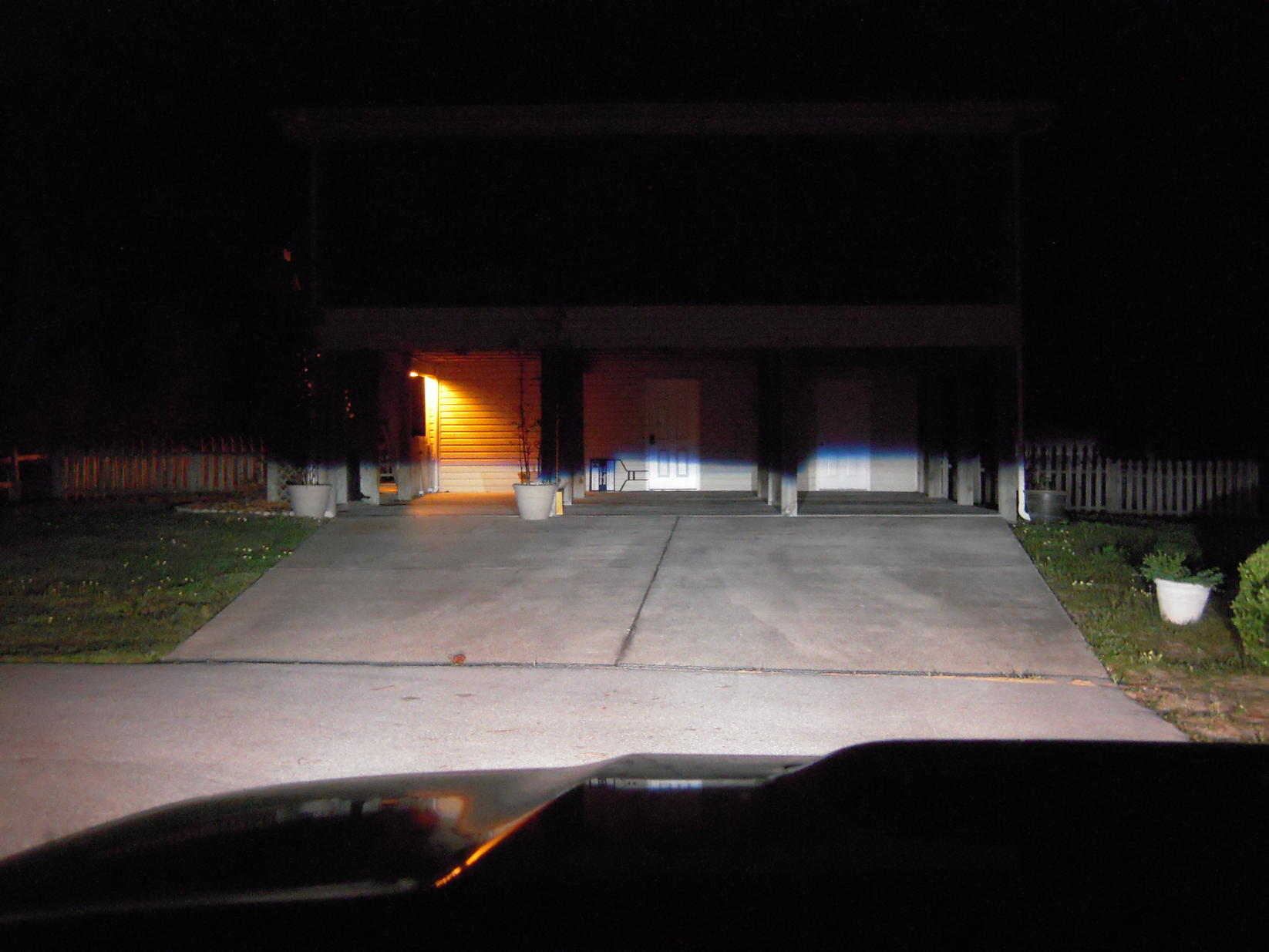

Well, I have her all zipped back up and everything is complete.
Overall I'm very pleased, the rotation isn't perfect, but acceptable. Left and right is fine. Will do a bit of adjusting tonight to try and tweak them.
Only problem I have, the bulbs just do not seem to seat well into the back of the projectors. My cut-offs are very colorful and I can tweak them blue/purple to orange/yellow or clean cut off depending on how I nudge the bulb. These are the Morimoto bulbs, I know I had Phillips 85122 last time...not sure if that makes a difference.

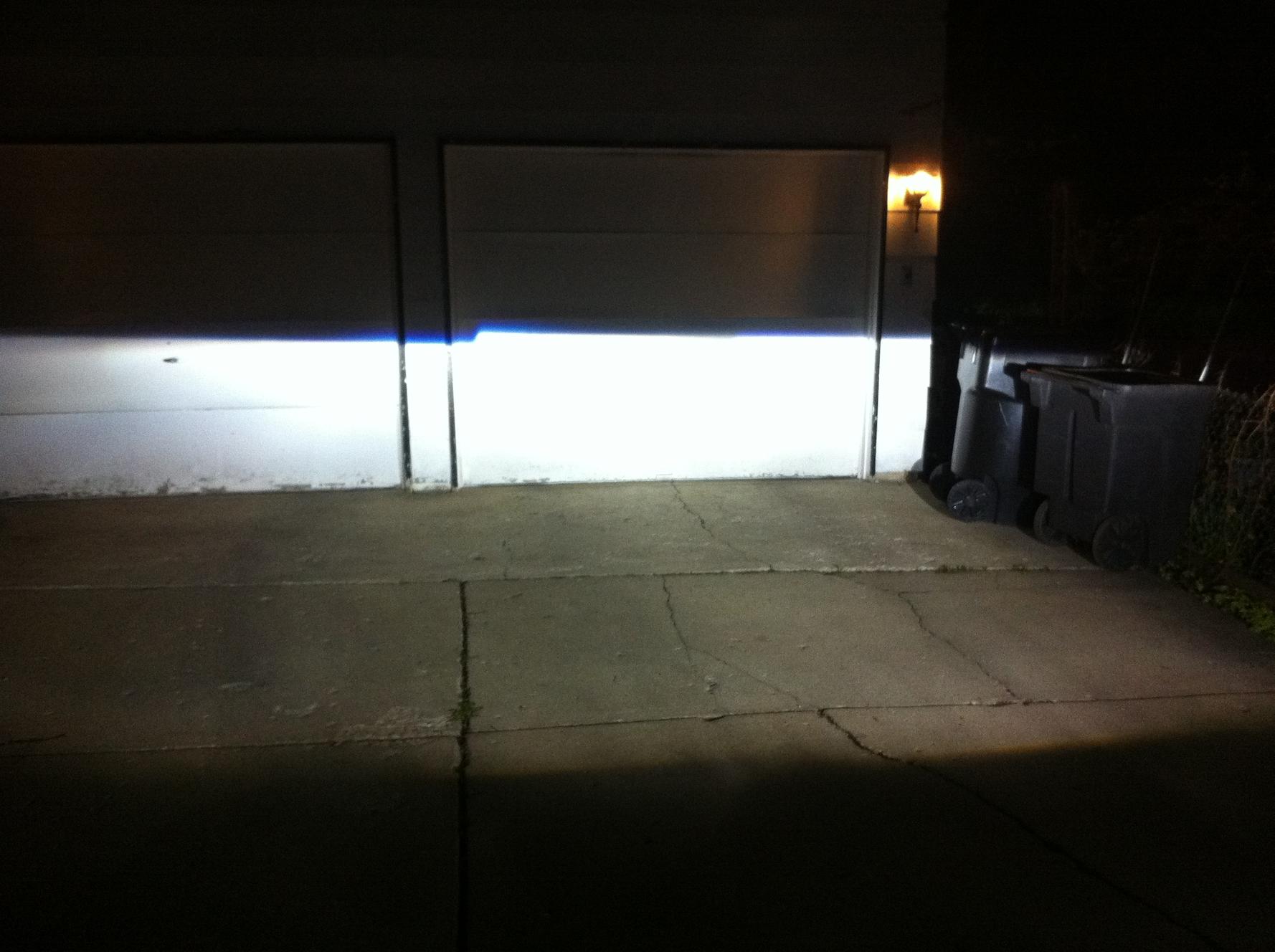

i just finished my fx-r retro fit last night. i think it came out pretty good. I'm on a pitched driveway,which is why it appears to ride up on the left side. Overall the cutoff came out pretty straight.
