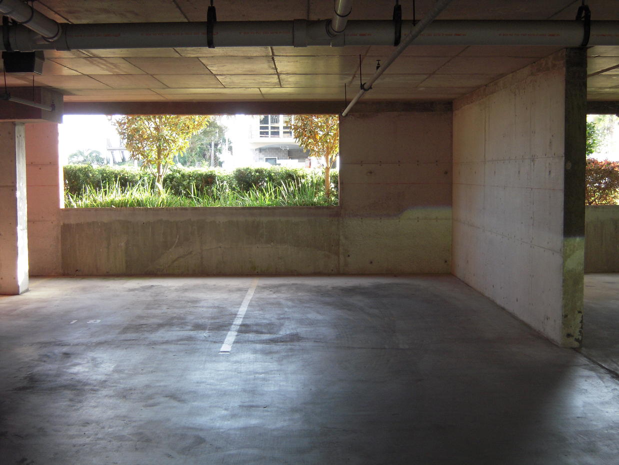

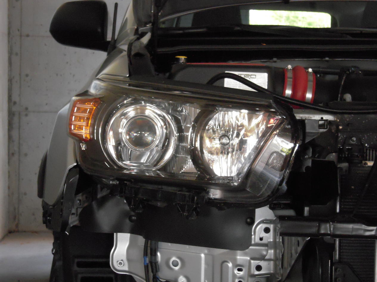

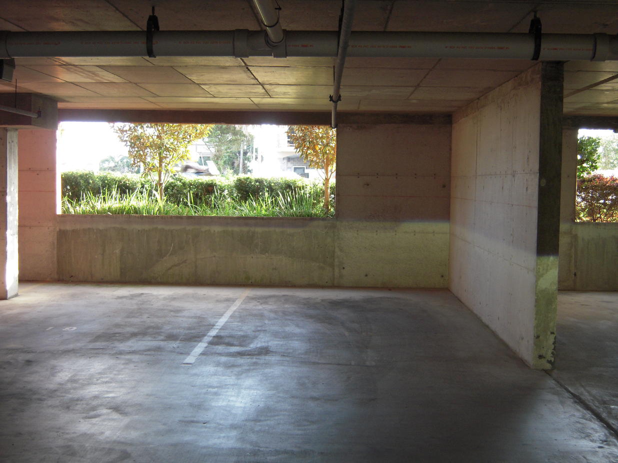

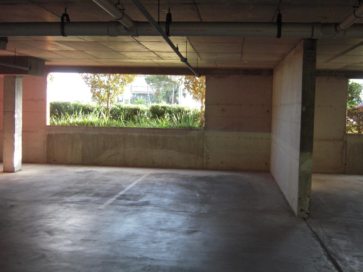

Hmm. Not sure to which pic you're referring. Do you mean the way it's mounted or the way it's projecting? Everything is aligned correctly at the moment. It might just be the angle of the picture or a camera effect.

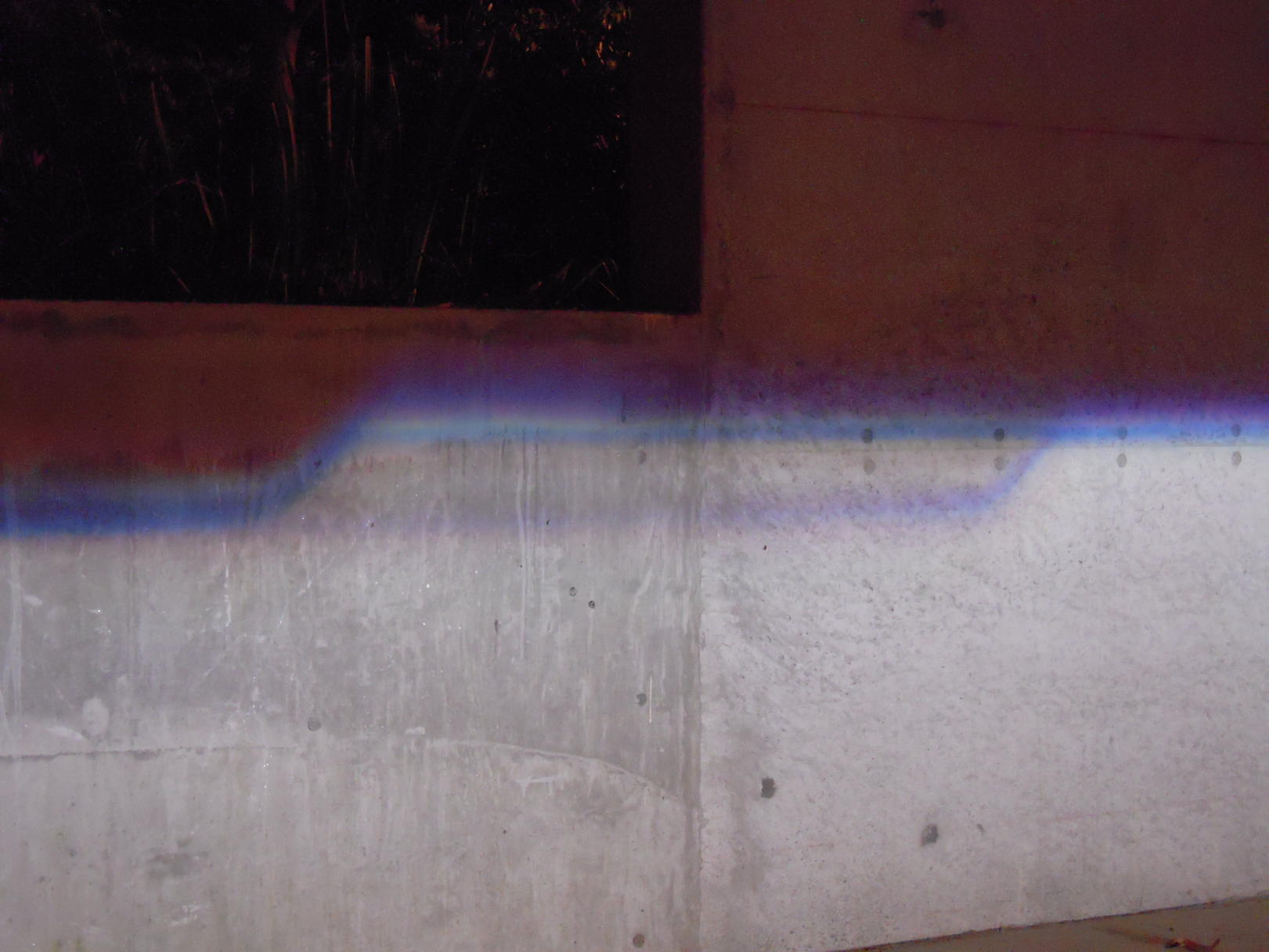

The third picture(on ur build thread), I think its in maybe a garage. It might be just the pic but the driver's side cutoff line appeared to a few degrees off. Sloping down towards passenger light.
Ahhh. Gotcha. Yeah, that's a trick of the camera. The garage wall juts out a bit, but the cutoff is actually straight in real life. Doesn't slope down at all.

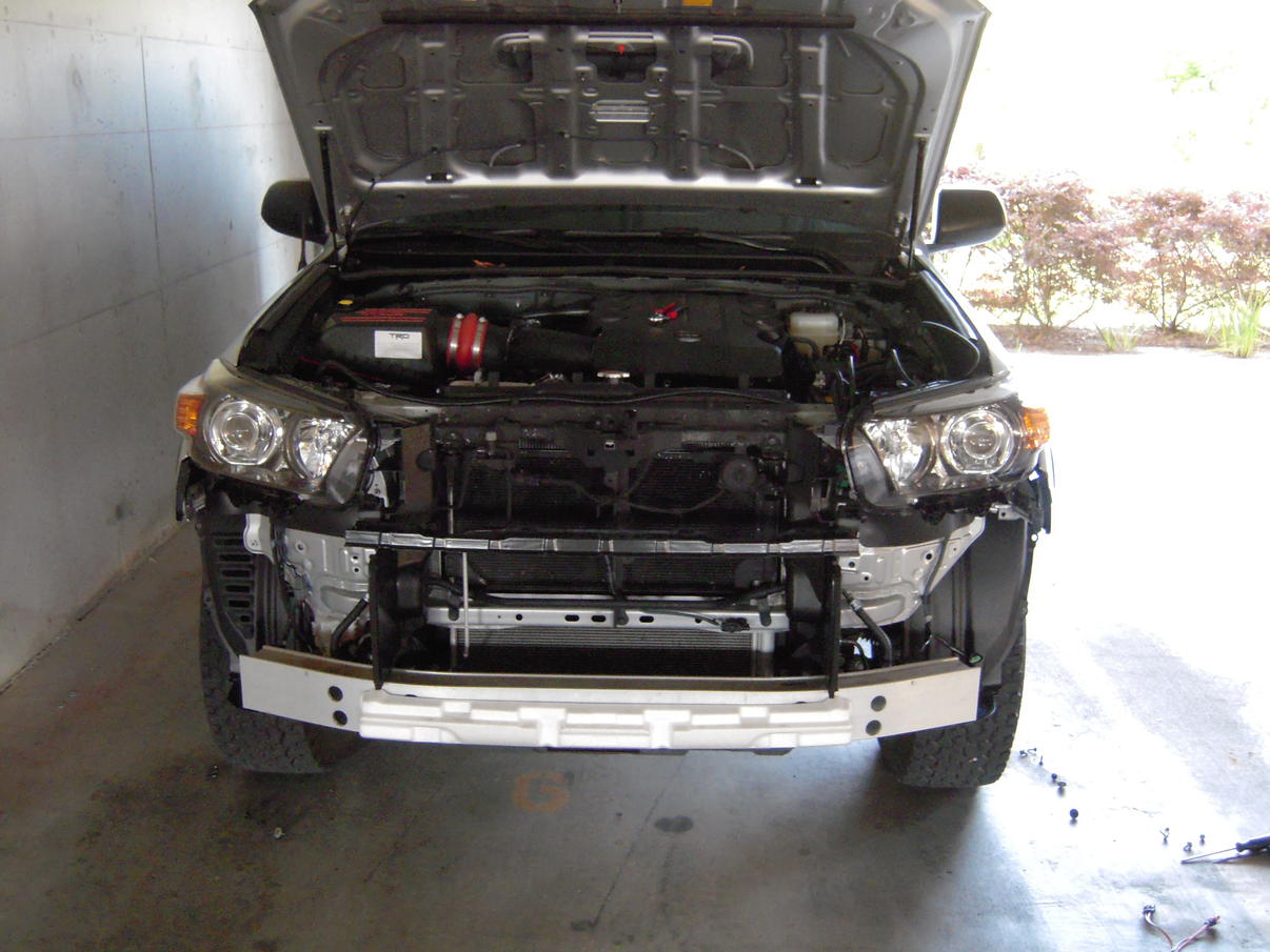

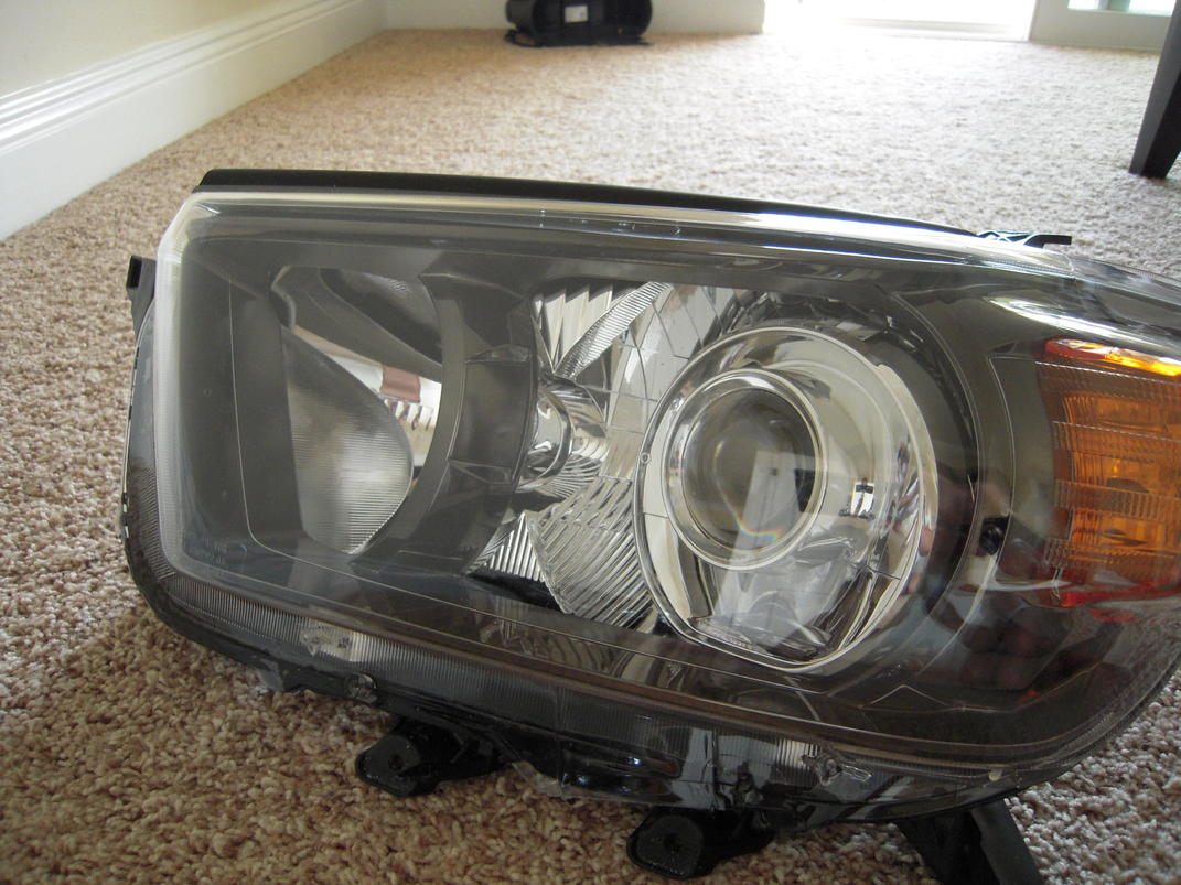

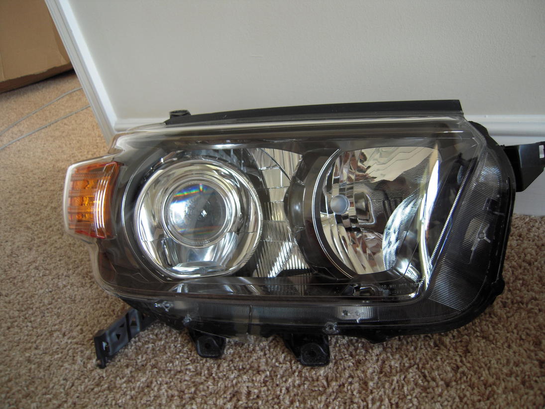

Got my headlamps from Lightwerkz back tonight. Debated for a few seconds if I had the time to get the bumper off, lamps in and back together before dark....Of course I do....

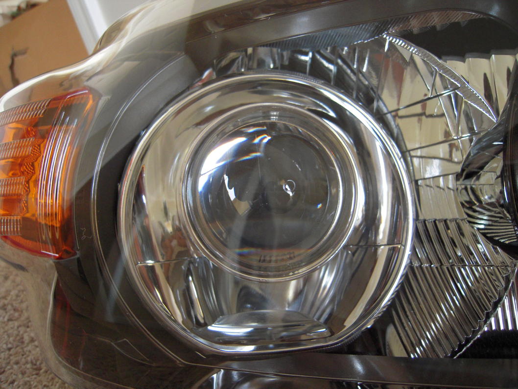

Here are some preliminary pics. It is too light out still to get any output shots, but maybe this weekend.
These projectors are HUGE!! I really love how massive they are, I think it fits the 4Runners attitude well.

Very nice. I like how the projector sits off center vertically in the housing, interesting effect.
Lightwerkz does good werk, eh?
Really impressed with Lightwerkz quality and timeliness of work and customer service. I highly recommend them!

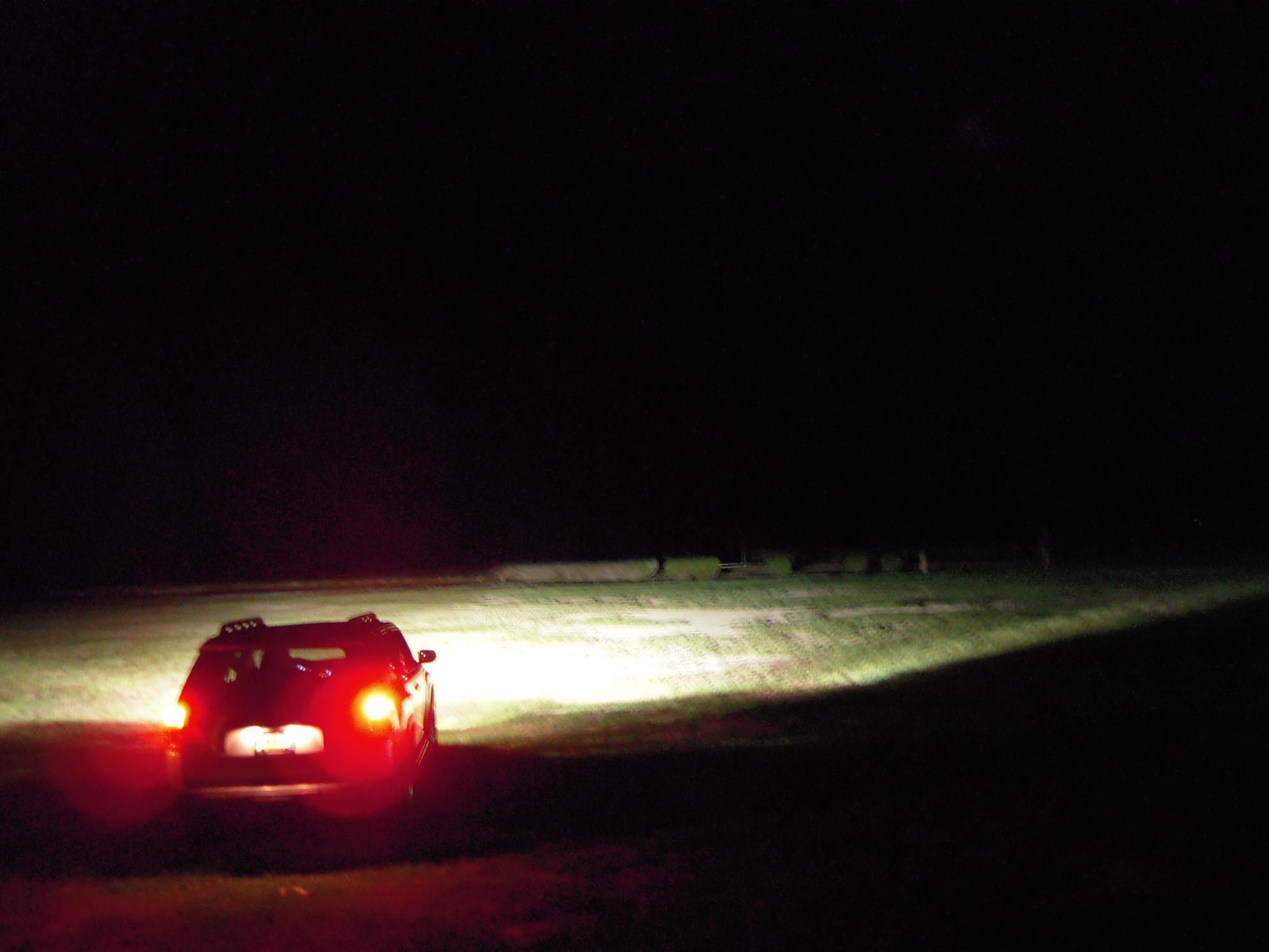

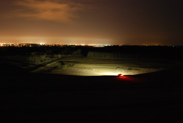

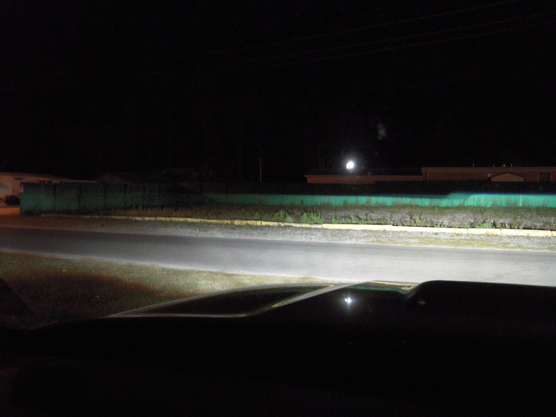

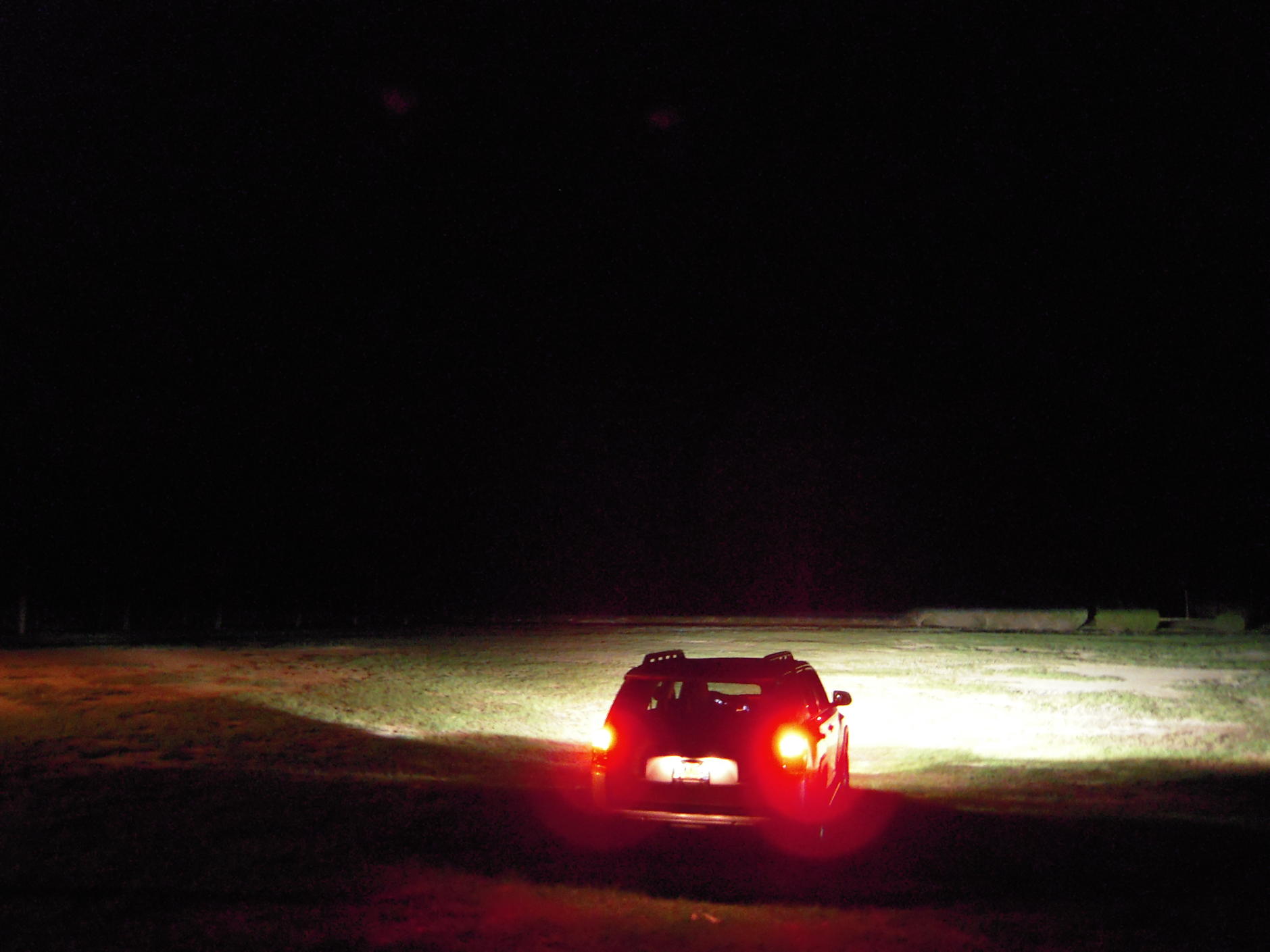

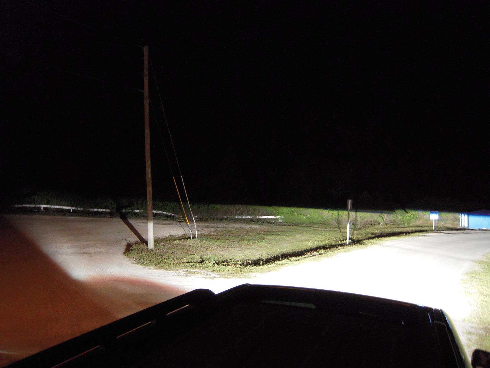

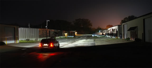

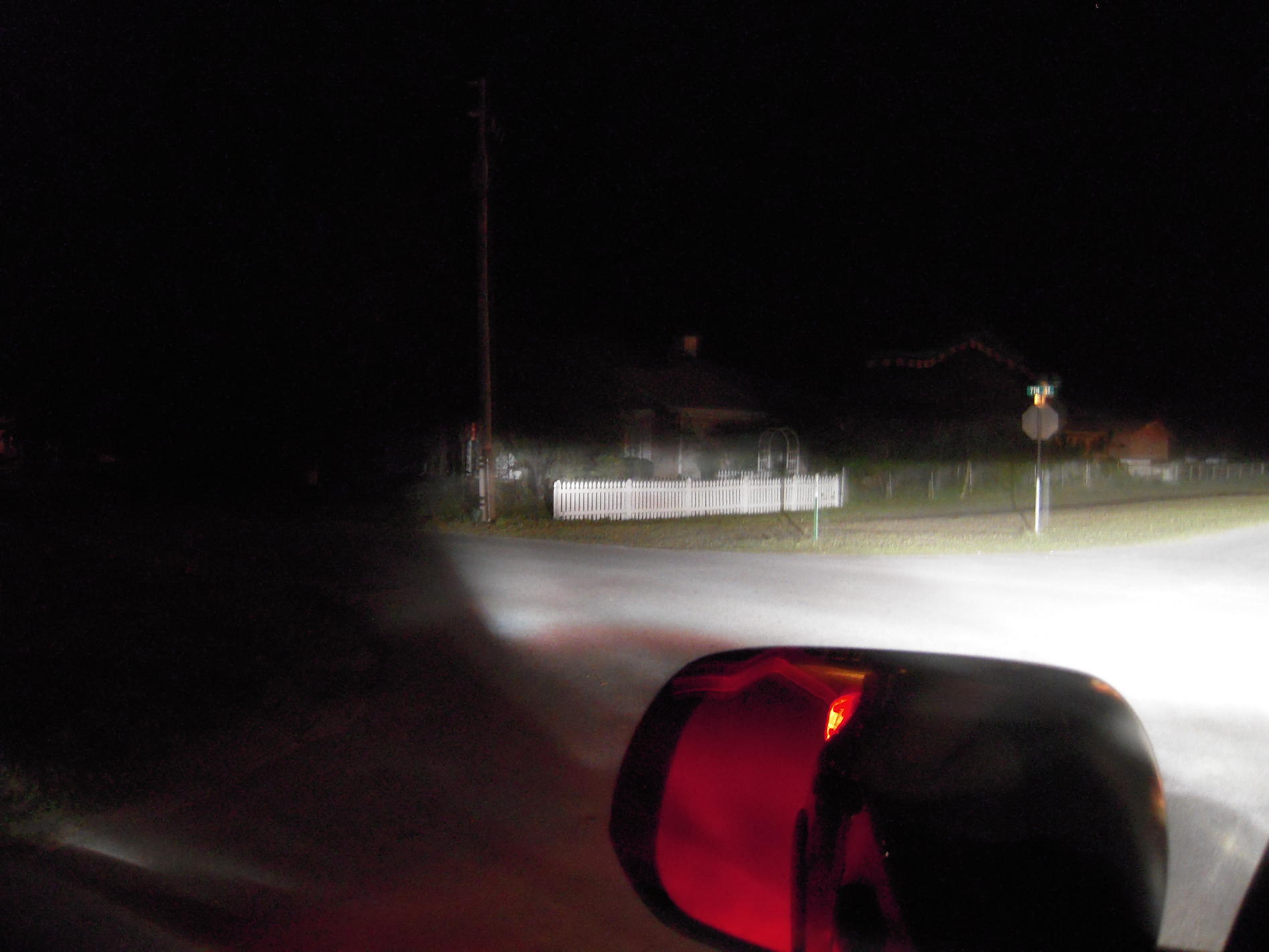

Here are some output shots from tonight. These projectors really are ridiculously W I D E !! The TSX-R lenses really add color to the cut-off too.
I couldn't capture the whole thing with my cheapo camera. There really is a straight and equally intense light output from 45 to 135 degrees. I did find a ball field with a shack behind it. I figure I can park in front of it a ways, then jump on top of this shack to get a good pic. Excited for the weekend already haha.

.... These projectors really are ridiculously W I D E !! ....
This was my first most vivid impression too .... the light spread, and how well the sides and shoulders of the highway is lit. Particularly on dark 2 lane roads.
