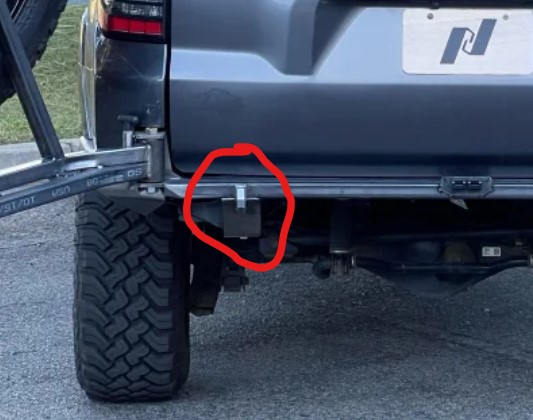

So you only want high clearance at the rear most corners of the truck?
Technically you would not loose any real clearance by leaving the crossmember, except down the center of the bumper....as the frame rails are still present. The lowest point is your limiting factor.

I have their bumper with the crossmember, and below are a couple of pictures for reference. The last two show a crossmember cover that I designed, and it really cleans up the look.
IMO, I would ask around about other issues and not worry so much about the crossmember. Start asking people that have about 8-10k miles on the bumper what their thoughts are. This would be my concern in the bumper decision, and not the crossmember.
Look at that same thing from the side. Its not a straight down rectangle as your photo portrays it to be.
The crossmember would extend beyond the rear bumper and sit under it 3-4”

So is this the stock hitch? My reasoning for more looking at Nguyen Works is the higher clearance, but I would like to keep my hitch for towing and recovery. Any thoughts on how to get the hitch higher?
This is the stock hitch, and it's not possible to move the hitch higher than it currently is. Moving it higher would cause interference with their swingouts.
