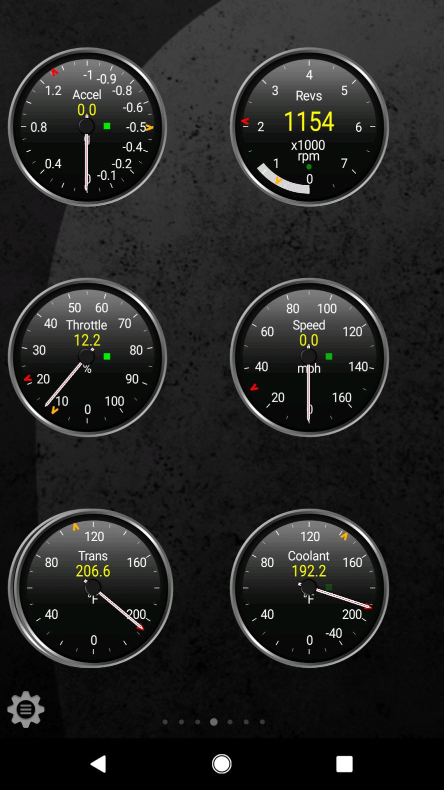

So I added enough to fill to the correct range. Was only a few ounces, maybe 1/4 quart. While holding the brake and accelerator at 1100ish my trans temp wanted to climb and climb. I stopped at 205 and let it cool back down to 180 before checking. Wonder if I have a clog somewhere?

If you hold the brake and accelerator while in gear the temps have to continue to rise until you stop doing that or something breaks. It's not a valid test for anything.

I agree. The whole point of using this technique of putting the vehicle in gear with the brake on is to get the trans up to operating temperature without having to drive it so you can check the fluid level and make sure it's in the hot range. I told the OP to use this technique to get the trans to 180 degrees so he can then make sure the trans dipstick level was at the top hot mark.
Of course the temperature is going to keep climbing because you're putting a strain on the transmission. This is not a test that mimics normal driving conditions. It's just a technique to raise the trans temp quickly to operating temperature.
