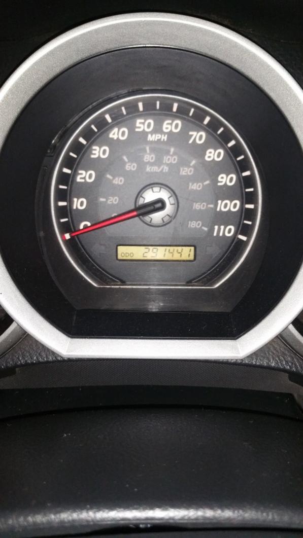

291,000 and change in my 06 V8 Limited, still going strong - bought from the original owner in AZ (rust free) with all records - only 2 timing services thus far.
Assuming the other services were done at 90 and 180k miles, I'd do another timing belt job if I were you. That's not something you wanna let go longer than you should.
