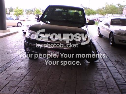

04rnr had his go out while going around a highway loop on ramp at about 45 mph. It totaled his awesome 3rd gen. Luckily it didn't roll.
is it just me or do they all seem to snap from low speed turns?

I have 100k on my LBJ and have some OEM ones waiting to be put on. This picture alone makes me want to do it every 100k. Its really not that much money considering what could happen if they break.
