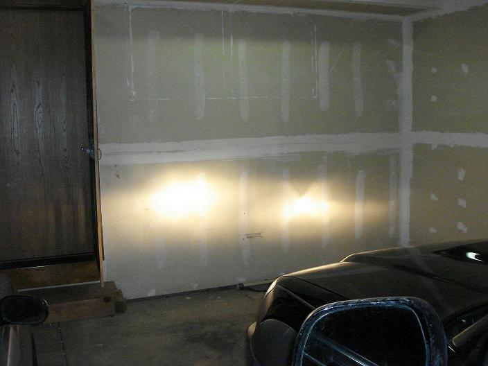

Ok here is the pic I took side by side with the HIR on your left.

I'm so f'n lazy. I installed 1 HIR bulb into my 4R last month, but haven't dragged my ass out to take some comp pics yet.
BTW: I bought the 65w bulbs, Toshiba HIR, from the ebay seller. Great service, and the light is waaaay brigher than 55w OEM bulb. I'll have to compare the 65w silverstar bulb that I have lying around to the HIR 65w too.
Summary: if you want WHITER light and shorter life, buy Silverstars. If you want BRIGHTER light with a (reported) longer life span, buy the HIR.
Although HIR are twice the price of SS, I'm not disappointed at all. I'd love to go HID, but I don't have 300-400 beans to blow on headlights right now. I just want to see betta.
not sure about the aim of the lightbeam.. I tried messing with it several times and couldnt straighten it out. Does anyone have any tips on that?
Update: it's been 11 months since I installed my first HIR bulb and I have yet to burn it out (knock-knock). I still think they are a great value: very bright for a relatively low cost.
