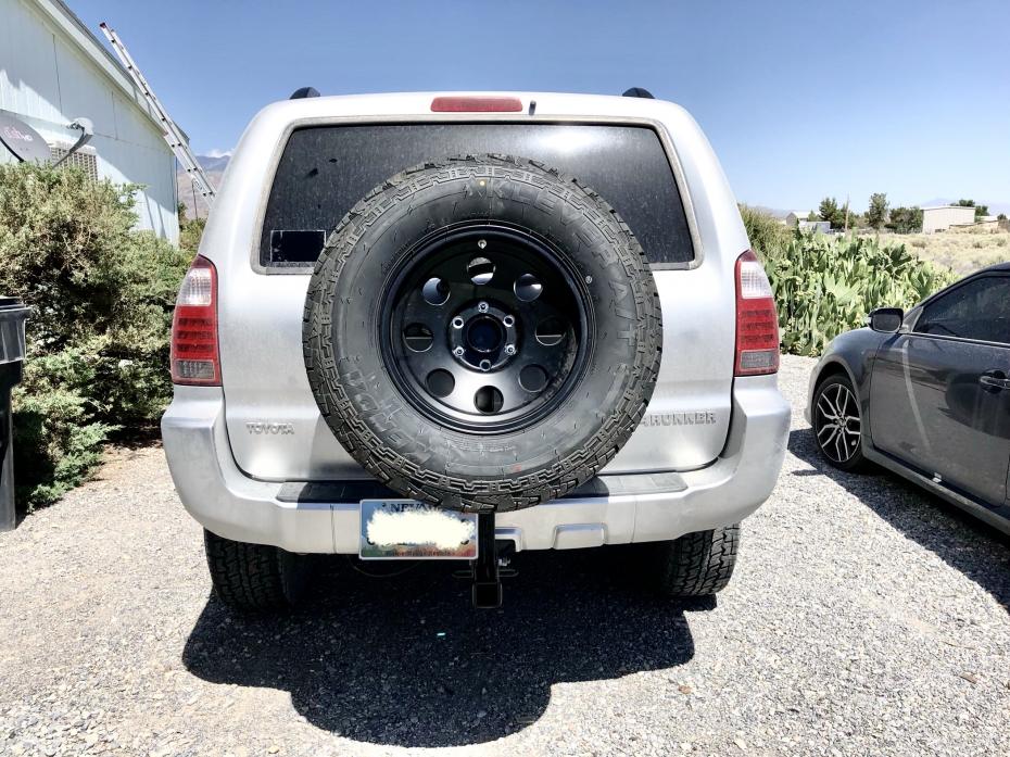

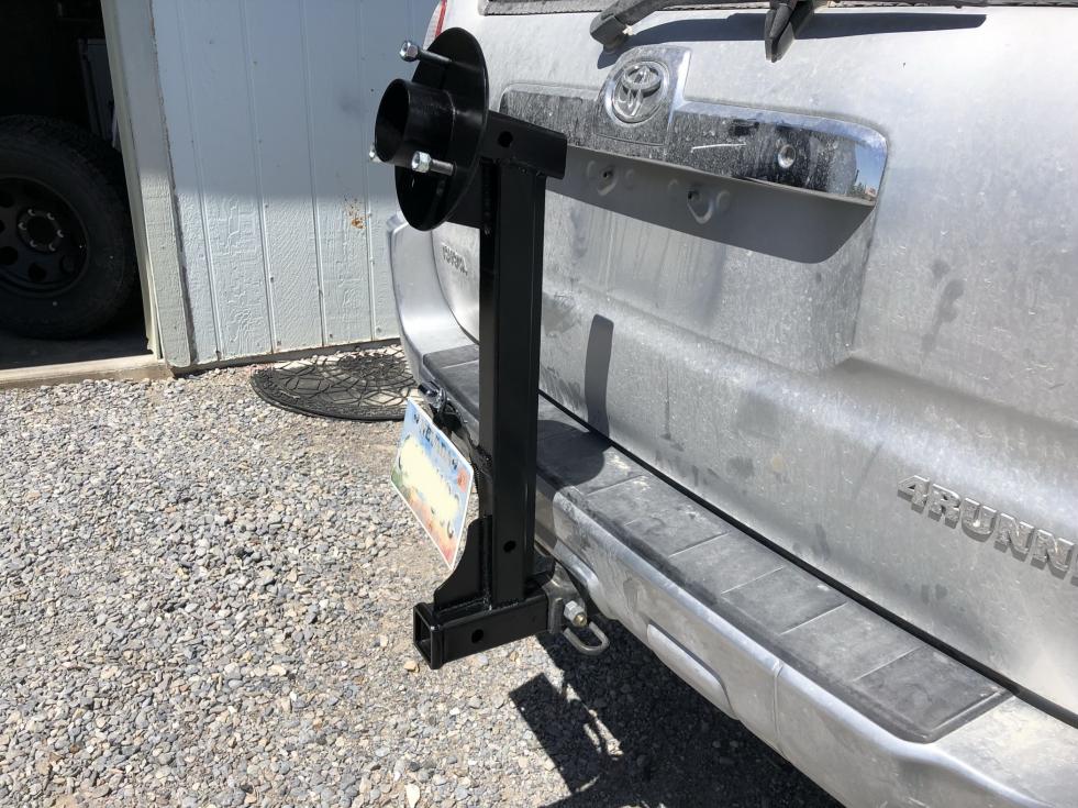

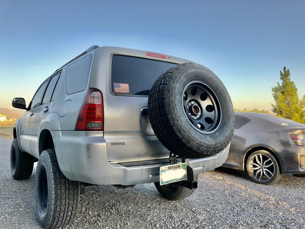

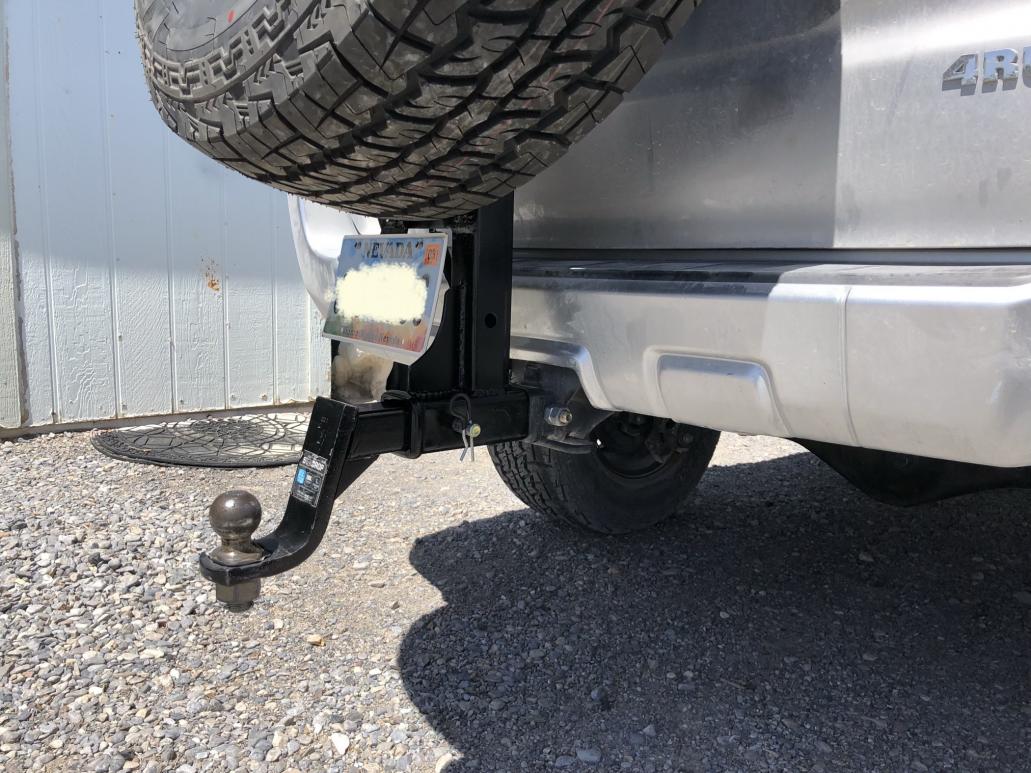

There's always the DIY route. I'm in it for right around $100. I don't run it daily, I just wanted to add it for a 10k+ mile road trip coming up to Canada and Alaska. Took a Curt RV spare tire carrier, cut it at the 90*, then bolted it together with to pieces of steel.

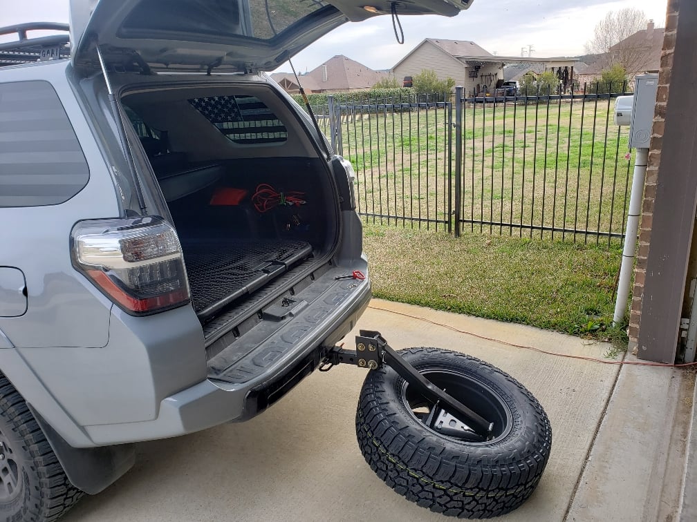

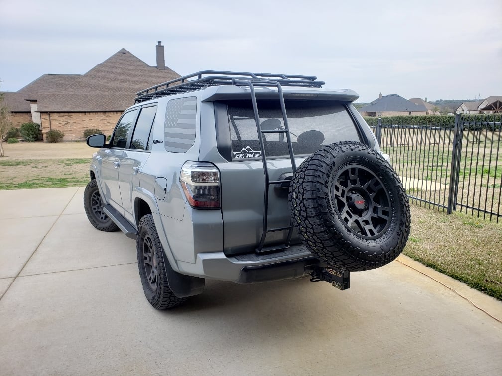

I have the Detours of Maine drop down tire carrier. It works, but it requires some strength to lift the tire back up into the upright position. Swing out would be easier to manipulate, but costs more.

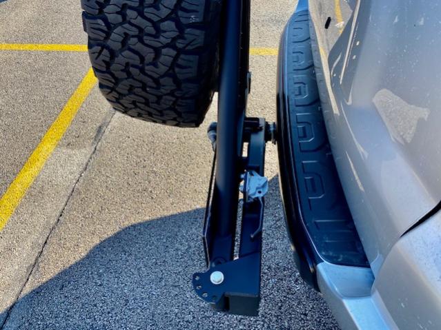

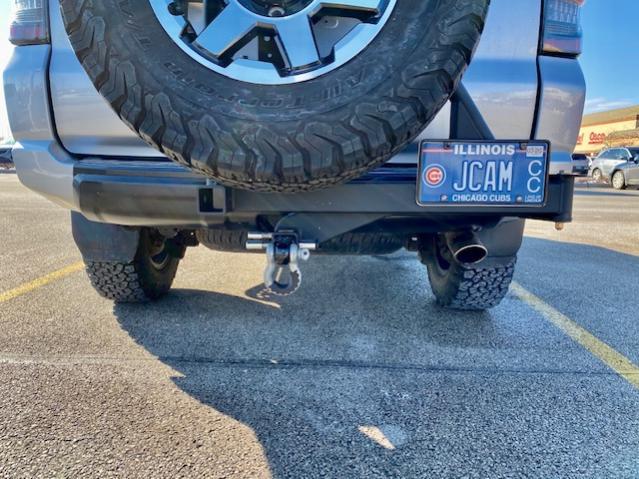

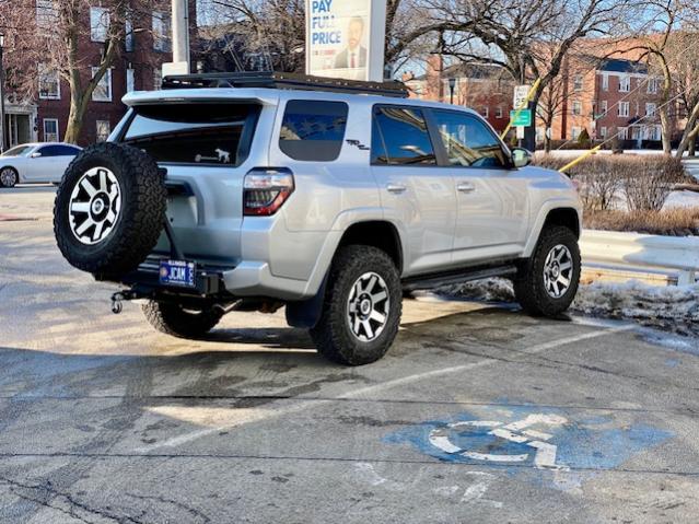

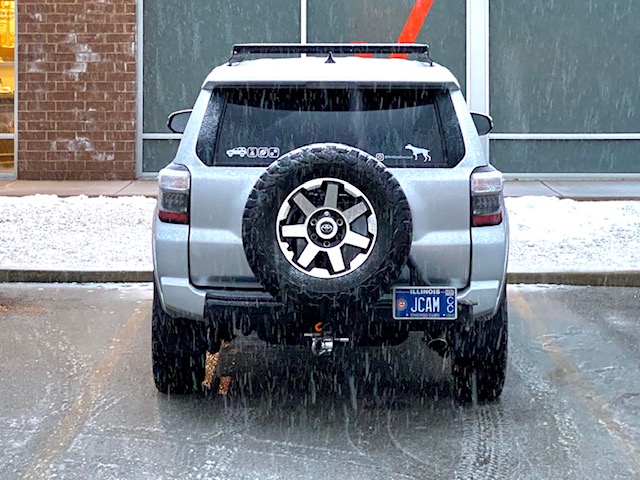

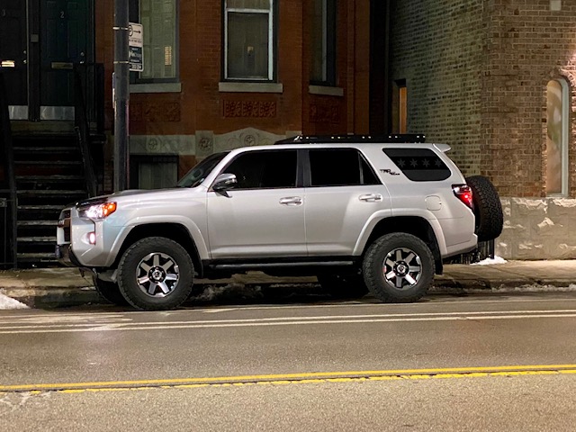

Had Rigd for a week now...
Love it. I considered the others as well and narrowed it down to Rigd vs Detours of Maine. The Rigd unit comes assembled, powdercoated, and accessories are easily added. The DOM unit is cheaper, but comes raw steel. It sits a little closer to the truck which I like and slightly better departure angle for offroading. Overall I decided to go with the Rigd unit because after powdercoating the DOM unit the price difference is little. I also like that I can mount my accessories easier with it. Quality piece.

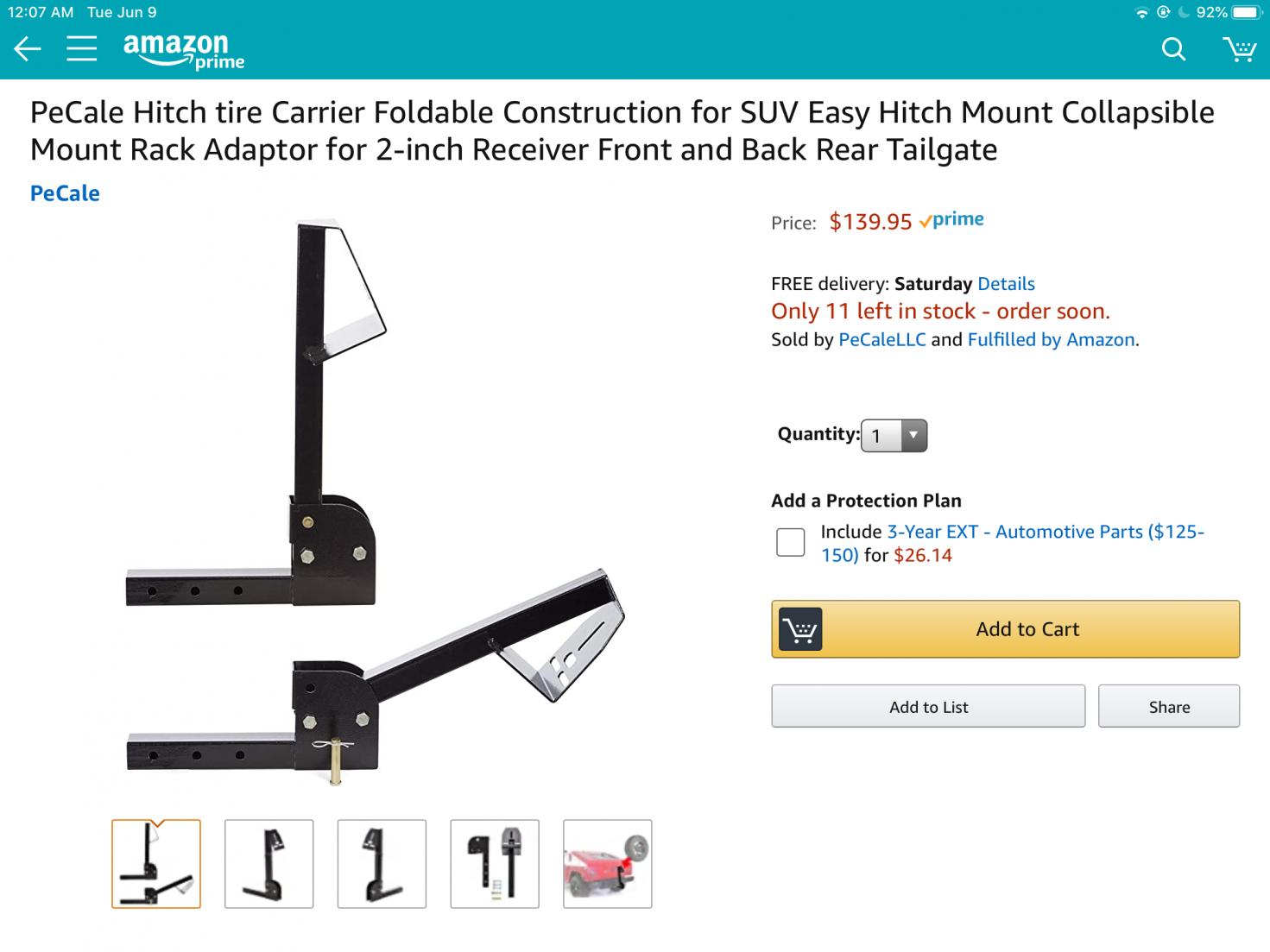

Low cost solution
Maybe some slight mods to make this one work, but less than $150!
