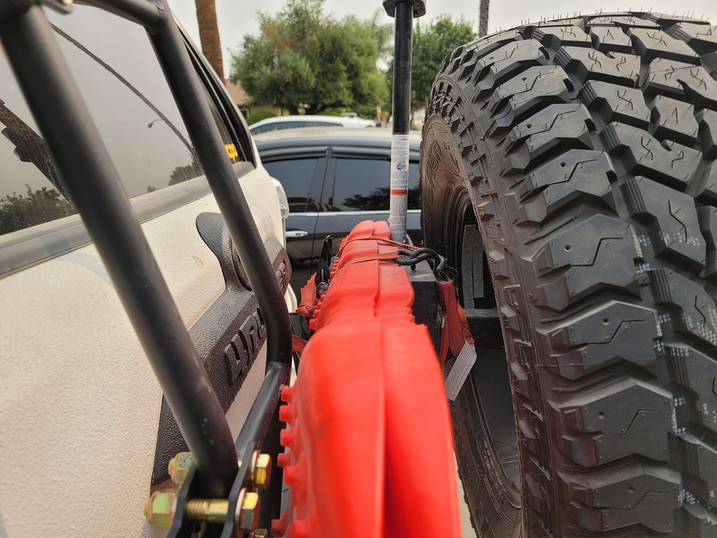

You ever had any issues with the Rotopax leaking since you have it mounted flat?

No issues with rotopax. I only fill it up when I go off-roading so it doesn’t wear down as much.
