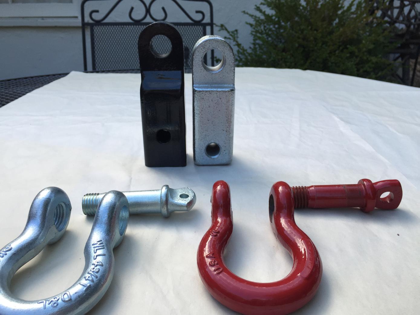

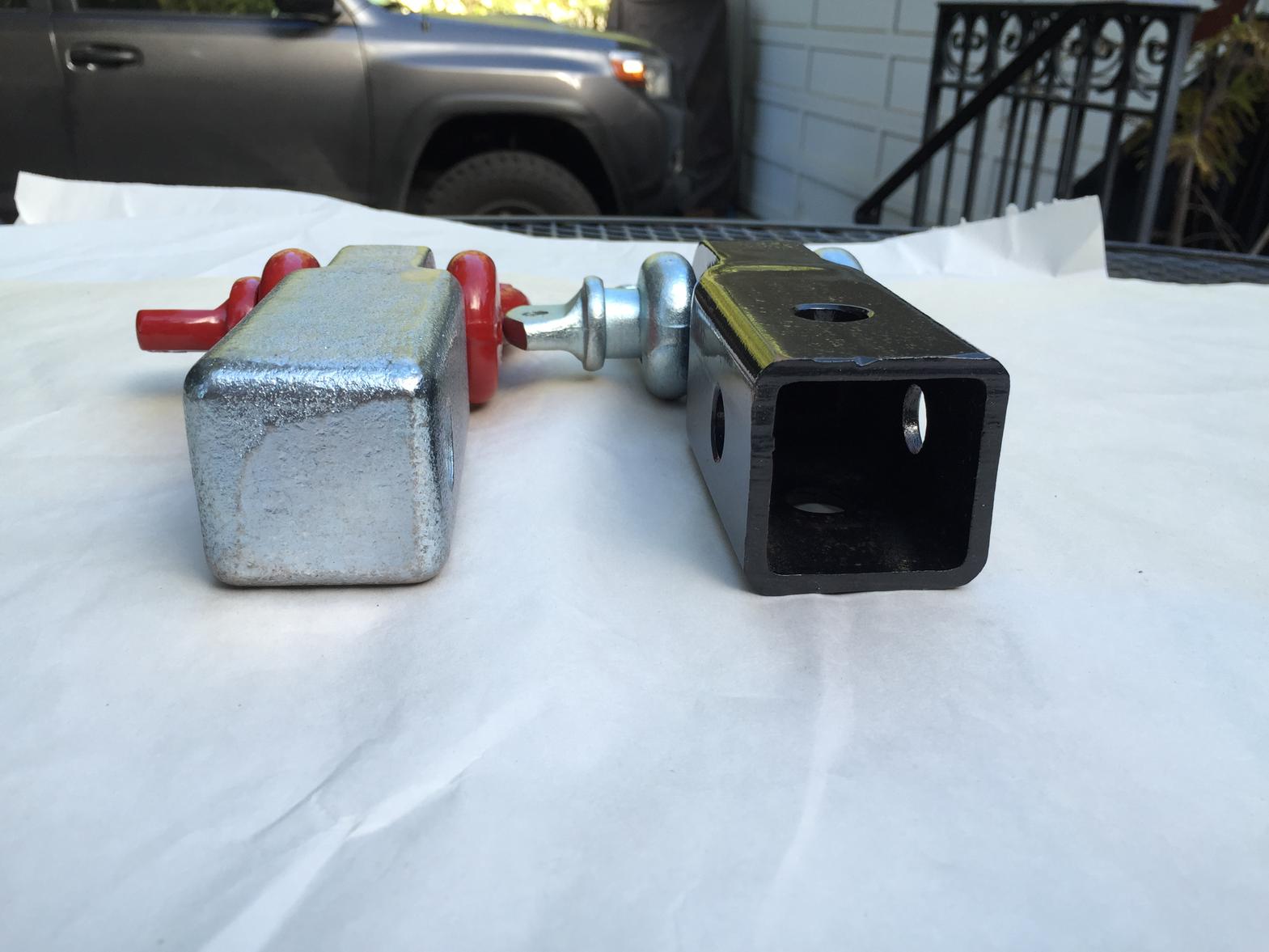

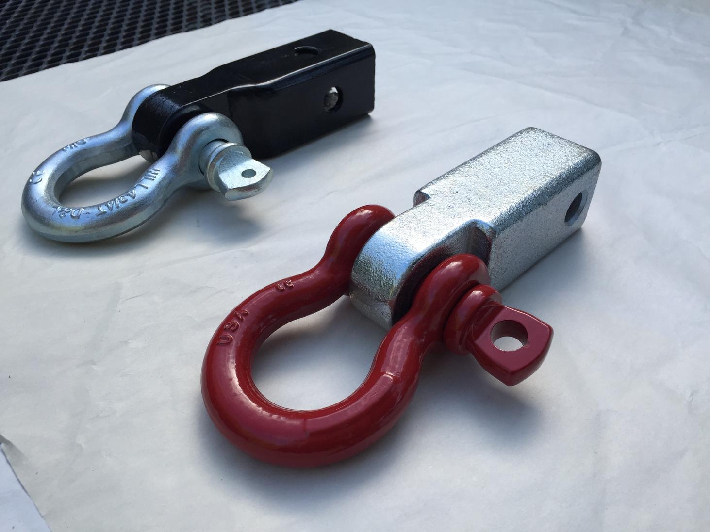

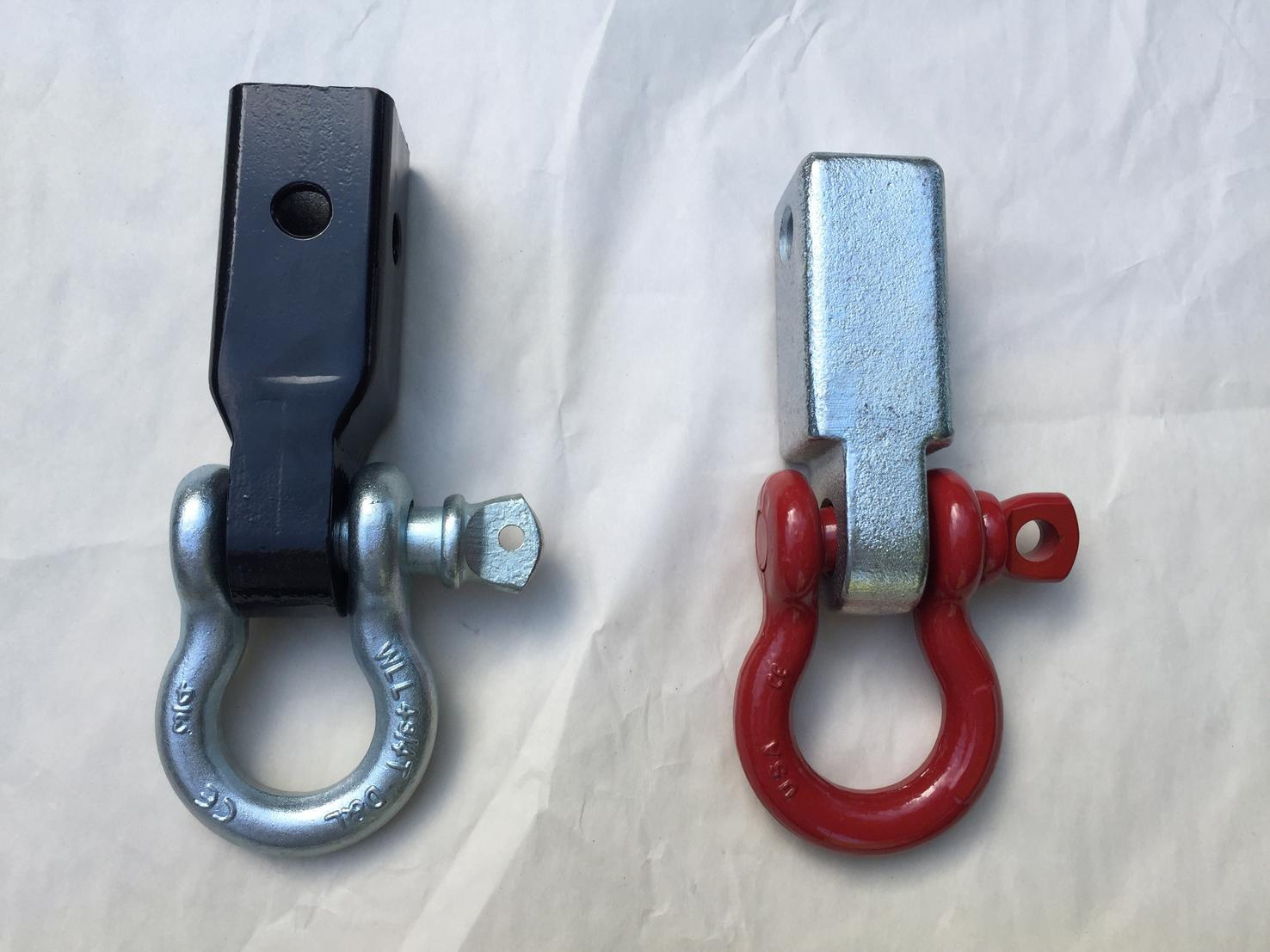

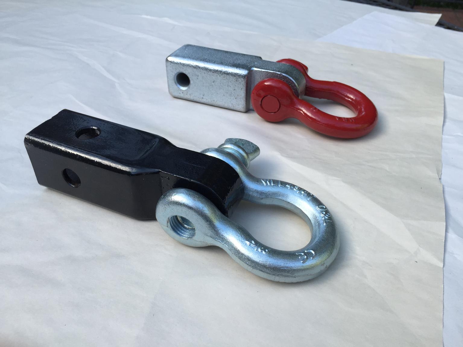

I'll preface this by saying I have no ties with either of these companies, this is purely a user's observations that may be helpful for others.
I thought I'd share my recent experience with hitch shackles. My brother got me a Rampage hitch shackle for Christmas, however upon inspection neither of us were very impressed.
The hitch mount looks like an inexperienced/sloppy chop-saw job and I question the quality of the steel. The pin on the included D-ring shackle doesn't even screw into the shackle all the way, even after using a tool for extra leverage.
For comparison is what I ordered next, a Billit4x4 hitch mount with US-made Crosby McKissick D-ring shackle. The hitch mount is a solid cast-steel deal and finely finished, and the D-ring operates smoothly and securely.
Granted, the billet hitch shackle costs double what the rampage "tube" hitch shackle costs. That said, seeing them in person makes me feel that the money was well spent. In my opinion, for occasional use the more affordable tube mounts will likely do the job, granted the D-ring's operate, but I wouldn't want to tow a disabled vehicle through the desert for 3-days with one.

That being said, I'm curious how they did the end; is it just formed/shaped into the loop at the end or is that a solid piece welded to the tube like my hook? I wouldn't be too thrilled with the D-Ring included based on how it fits, but that's easy to fix. The one thing I will say is that it does look to be drilled fairly far in, which means even if the steel wasn't the best quality in the enclosed tube of the hitch carrier it shouldn't rip out easily.
I do like that solid cast piece though! It looks great! :D

It's a solid end-piece. Looks like it matches the inner diameter of the tube, as it appears to be inserted when looking inside the actual tube. I'm guessing the builder then welded the exterior excessively, then ground it down to smooth it out and make it look tapered.
x2 on the deep drill, I liked that. I'll probably still return it though, the D-ring is useless lol. It's off amazon so I'll see what they say, I've never returned anything through them before.

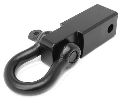

I have that Smittybilt. Have used it quite a bit with zero issues. Works well but i think I'd like to have a hook as well. Most of the recoveries I'm involved in don't require a snatch, just a slow and steady pull to get a rig over an obstacle (we're usually just trying to avoid body damage). A hook would be just fine for that and would be faster with the strap than a shackle.

I got this Smittybilt for Christmas. Haven't used it, but it looks solid.
i made one many years ago, that looks a lot like that.
we have ABused it a LOT for many years, no issues. its plenty strong. stronger than whatever straps/chains/cables we have hooked up to it over the years.
What is preventing that pin from screwing all the way in? It clearly has more room before it contacts the shoulder. Did you chase the threads with a tap?
