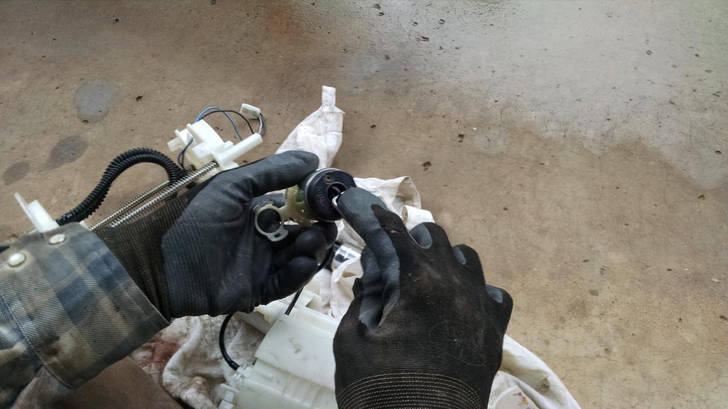

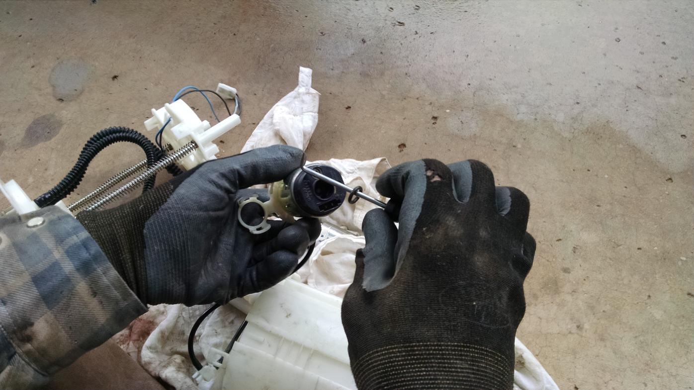

Well, the new fuel pump from Toyota is installed and things are running well. I still have the pressure gauge connected to the fuel rail and will see how the pump behaves under load.
One thing to keep in mind when you swap fuel pumps is to move over the O ring from the old pump to the new pump. If you don't, then the pump will have volume but not have pressure. Ask me how I know!
It's a shame that the new fuel pump doesn't come with a new O ring so be sure to order it separately. The attached PDF shows the part # for the 2008 T4R V8.
