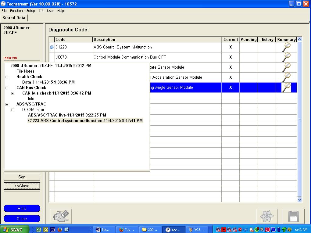

The DTCs stored in the Skid Control ECU indicate that the ECM is not communicating on the CAN Bus for some reason. While it's entirely possible that the scantool is having an issue, the fact that "Current" DTCs are stored in the Skid Control ECU are curious. Did you have any other DTCs in other modules besides the Skid Control ECU? (The "Stored Data" Tab will show the Health Check Results for all modules pinged when you did a health check.

I did do a health check and this is what I got back. Unfortunately, the XP box is back at home so I can't muck with it at the moment.
I did a CAN Bus check but not seeing anything under "info". I don't recall seeing any other fault codes from other ECUs. The stored data tab is shown below, not sure if I need to do something different. Still learning this awesome software.

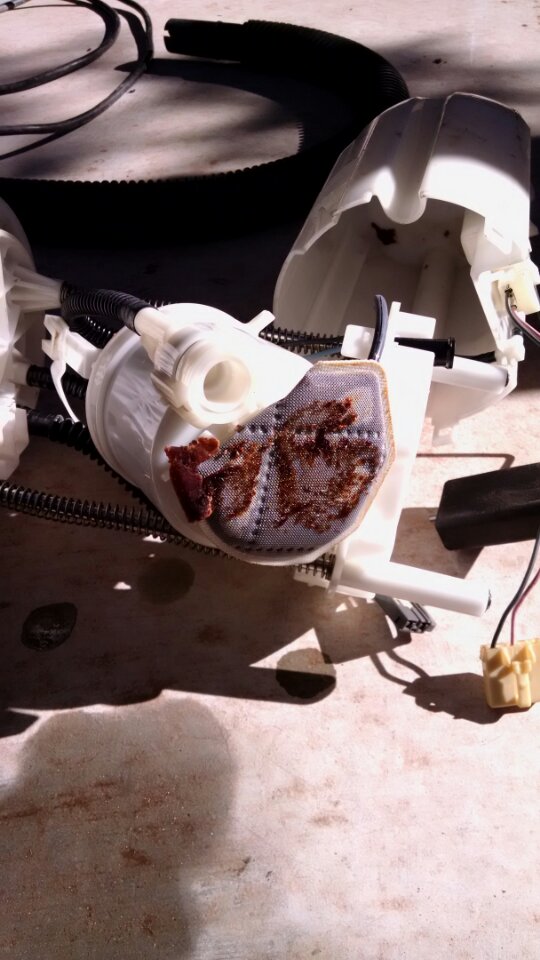

It's time for another update. After installing a fuel pressure gauge on the fuel rail, it was obvious that the fuel rail was losing pressure under load. I'm not sure what the normal engine running PSI is but I was hovering around 25psi with an occasional dive to 0psi or so.
Fuel tank was dropped and the fuel pump assembly removed to find that the pump strainer was clogged with contaminants that I can only surmise came from the in ground fuel tanks at the gas stations. Both sides of the strainer was fairly clogged.
Now, I'm on the hunt for a replacement fuel pump and strainer w/o having to purchase the whole assembly for mucho $$$. It's not worth replacing only the strainer just in case the pump impeller was damaged in any way.
