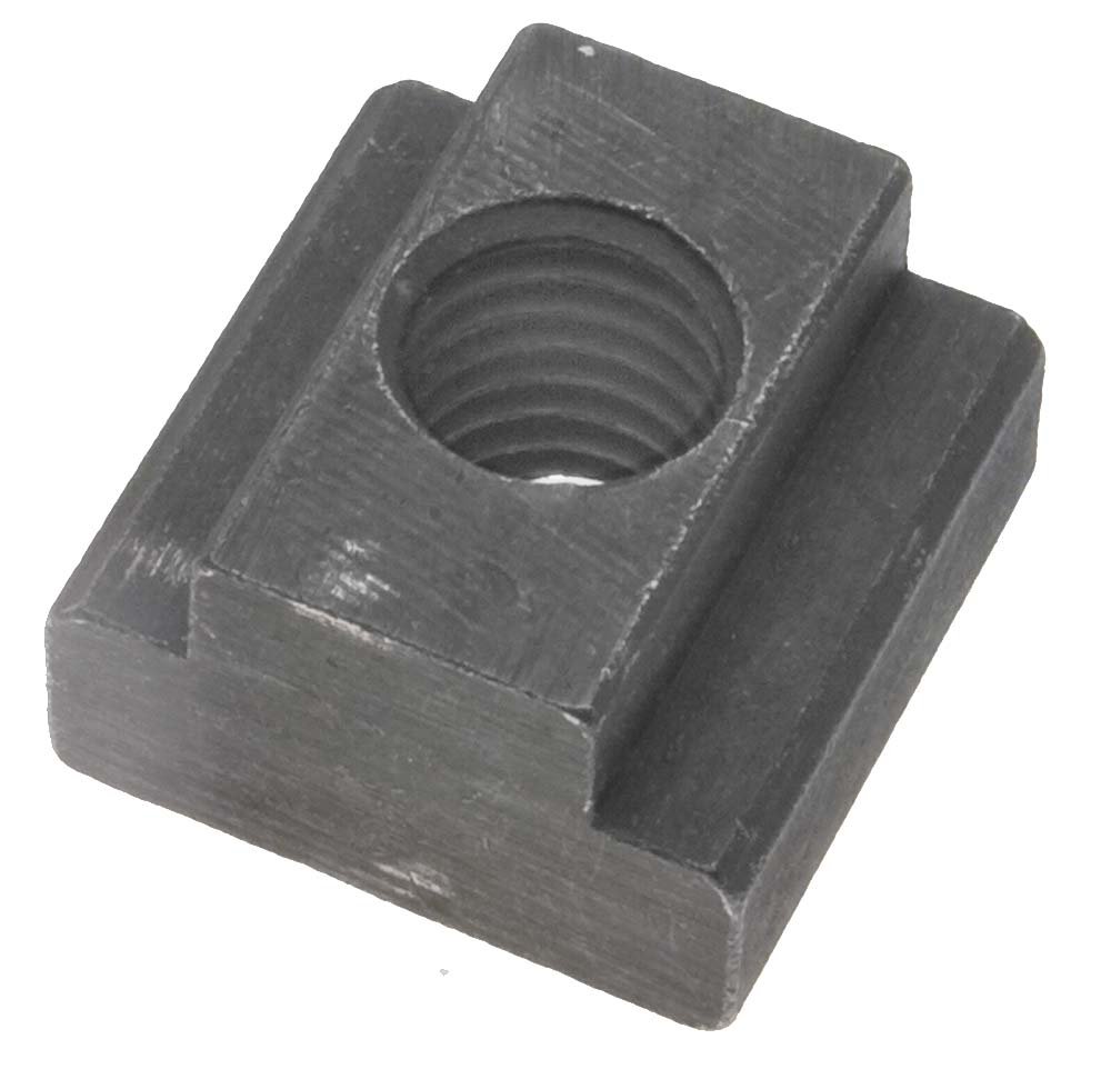

So, you're saying it's a simple friction fit that holds it all in place or said another way, 'clamping' to the factory roof rails. If it's that simple, that's awesome.
Some carriage bolt like this served me well:
Crown Bolt 3/8 in. - 16 tpi x 1-1/2 in. Zinc-Plated Coarse Thread Carriage Bolt-800236 - The Home Depot
You can also get stainless steel version.
Thanks for that. I got to thinking more about the t-slot nuts and I'm not sure they would do the trick as the 'table' or part that sticks out might stick out too far not allowing the rack to clamp to the rail.
I was thinking maybe a nut with a large shoulder or heavy washer tacked on would slip into the rail. But, a simple carriage nut (with the head on the inside) would work just as well I think.

Betty's Nephew makes a good point. Unistrut makes metal support systems for the construction industry and industrial applications. Unistrut also makes a T-nut that would fit. If you can find a supplier who sells Unistrut retail, look in their catalog.

I used the wrong name for the nuts I am referring to. Try channel nut instead of T-slot. They go into the open slot of the channel and when you turn the bolt the "wings" turn and snug up against the back side of the channel. Sorry about that. Google channel nut and there are pictures of what I was trying to describe.
Right on. The channel nuts look to be the ticket. They'll hold against the rails for tightening while providing a good amount of surface area for clamping and frictional resistance. Thanks all.
