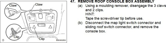

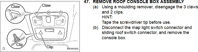

Seriously, it's extremely easy.
20 seconds to put tape on the tip of a flathead screwdriver.
20 seconds to stick the screwdriver between the headliner and the console on the windshield side and pop the clips
20 seconds to remove console and unplug the terminals, then clip them onto the new console
20 seconds to reinstall.
10 seconds to say 'techno was right!'
