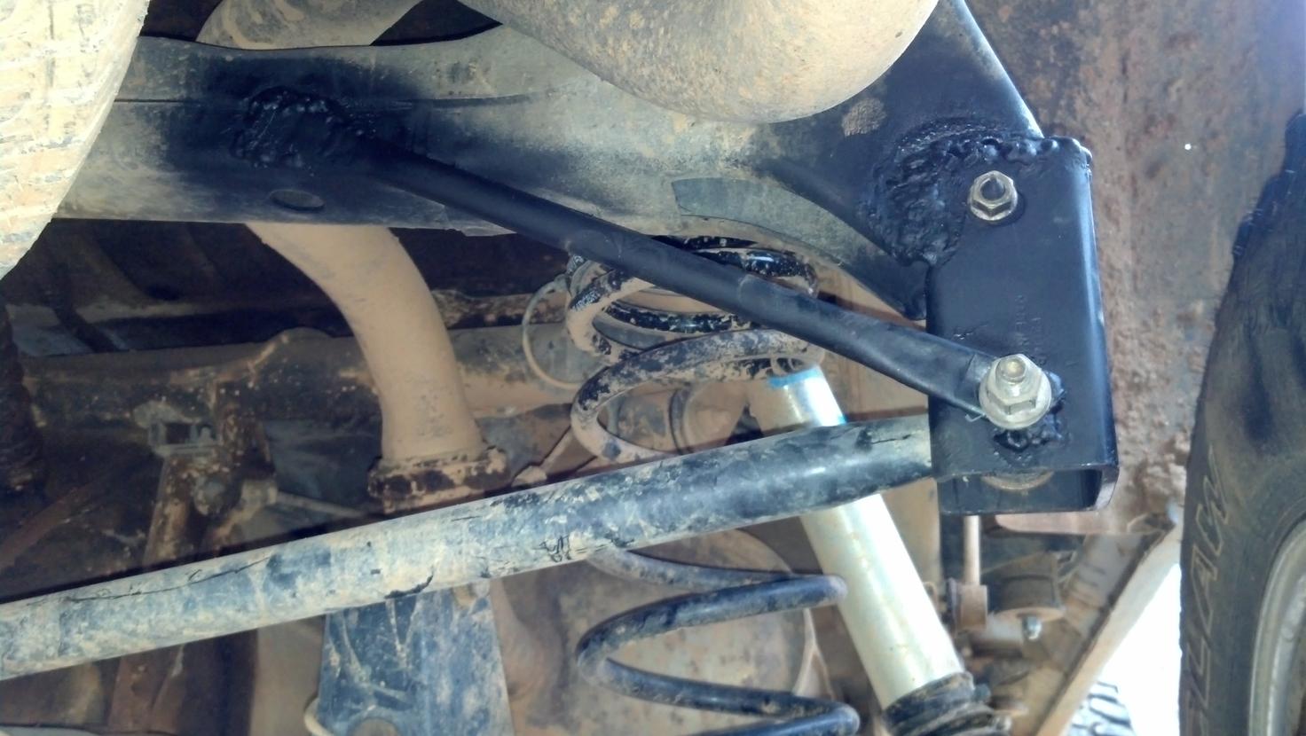

Hey, my mind wouldn't allow me to buy a drop for $50, I really like Toytec, but that's a little crazy. I searched for a good homemade option and C channel seemed like the best idea. One night at walmart I ran across a 2.5" to 2" hitch adapter sleeve for $12. I had to cut one side off and grind some of it down to fit, but it works perfect! Just make sure to weld it, and I added a small brace for peace of mind.

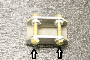

For you guys that built your own, should the bolt holes be 3" apart center to center on a 3" lift to get everything back in spec or is there some other factor that I'm not thinking of?
Please don't weld anything else structural until you learn how to weld a lot better.
Practice on bumpers and things that won't kill you if/when they break!
I do like the idea of the brace you made, just the execution needs some work.
I will admit that I am not a great welder but I do know how. That was welded and rewelded, looks like ass but has held up great for 12-15k on road and plenty of offroad. Even went and tried to break it near my house after finishing to test it. I appreciate the concern, honestly, but as bad as it looks, its solid.
A Lincoln mig welder, the wire feed was slipping some so I had to grind it down and re-weld and in the process it came out looking not so great.
I didn't see this answered and I am curious to know too. thanks
The idea of dropping the pan hard bar is just to get it parallel with the axle again. Not really sure on the exact measurement between holes. Technically, if you place the bolts 3" apart from center to center for a 3" lift. If you're springs start to sag, you'll lose you 3" lift, and then the pan hard bar will be to low. So people don't like them, and some do. Some people don't like adjustable pan hards, and some do. It's really a matter of preference, and it also depends on what you use your rig for.
