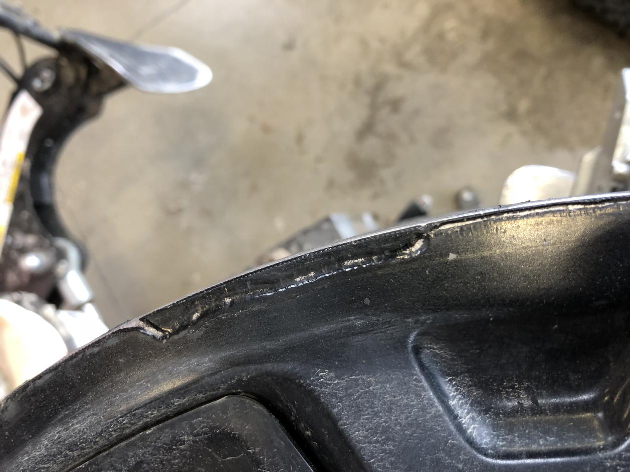

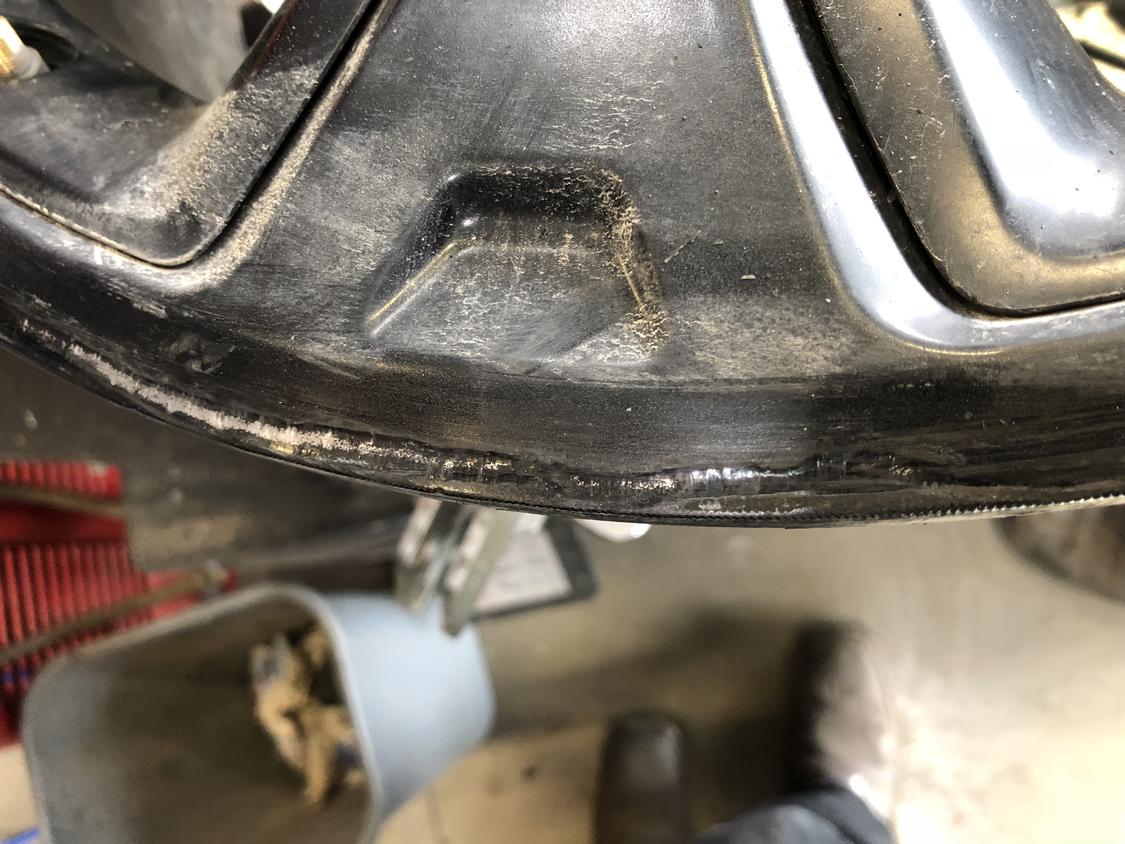

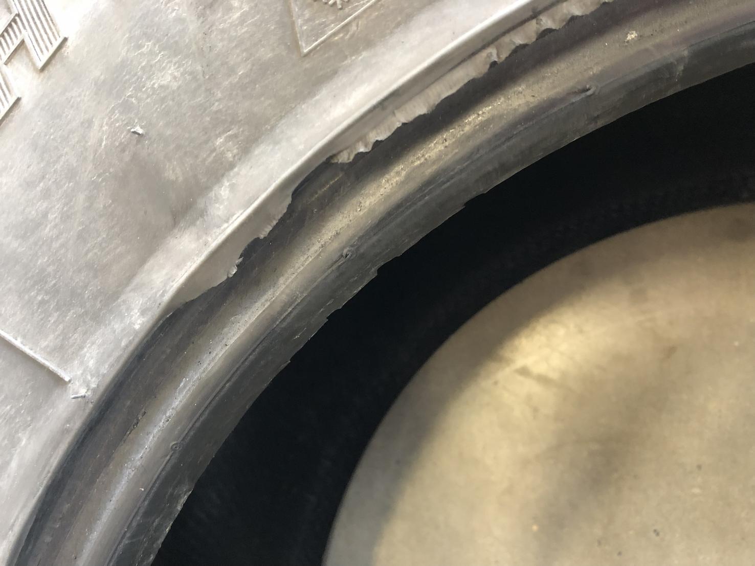

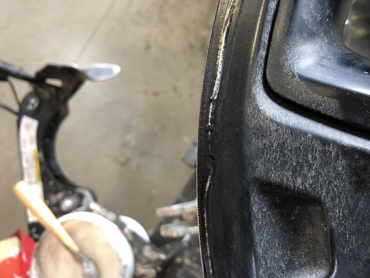

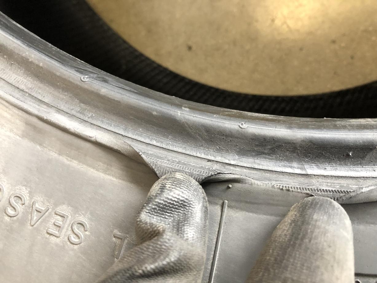

Sorry about reviving an old thread, but I had my first experience with treadwright tires today and wanted to share. I remove some treadwright wardens off a customers vehicle and found that the “rim protector” had failed and flaps of runner were resting on the face of the wheel and managed to remove the finish down to bare metal on all 4 wheels.
Just a heads up for anyone wanting to put these tires on wheels they care about.
