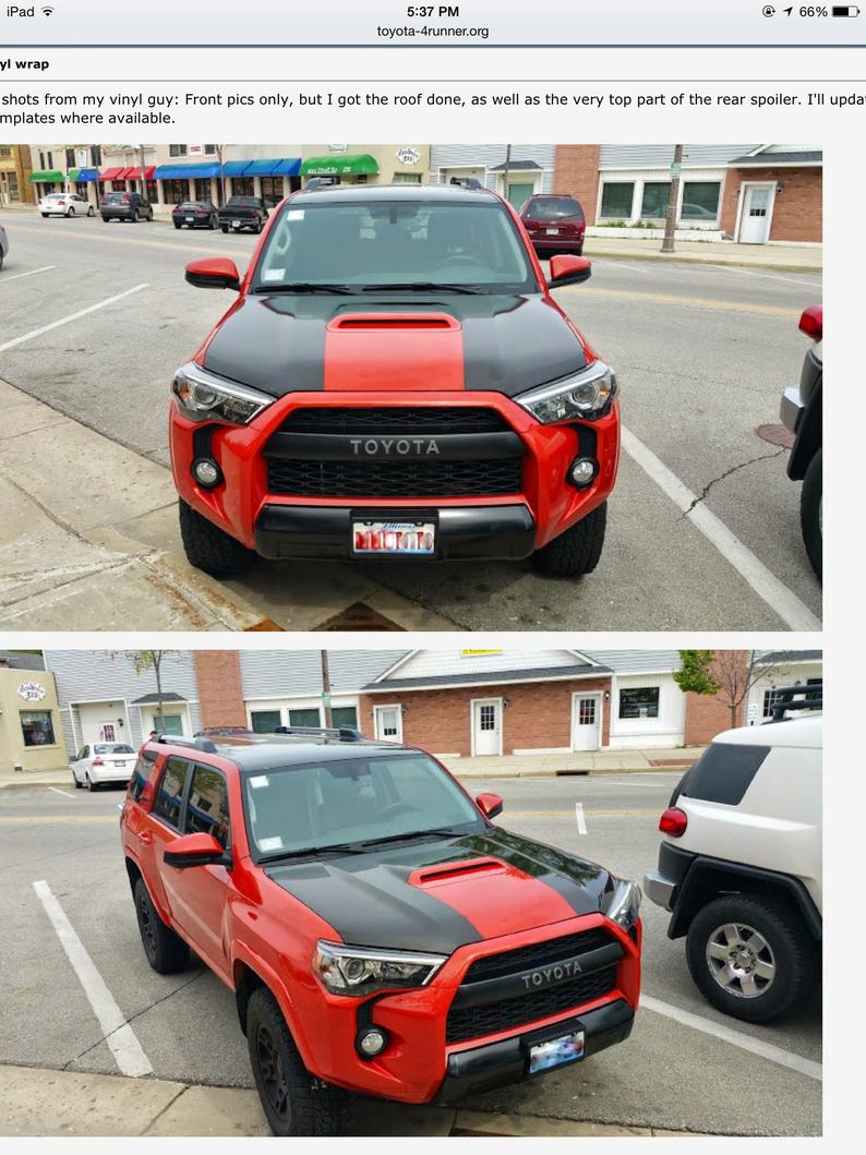

Hope "Gearhead1" doesn't mind me posting pics of his truck, but I really like his mod
