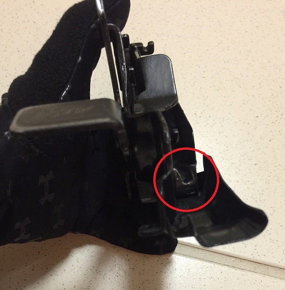

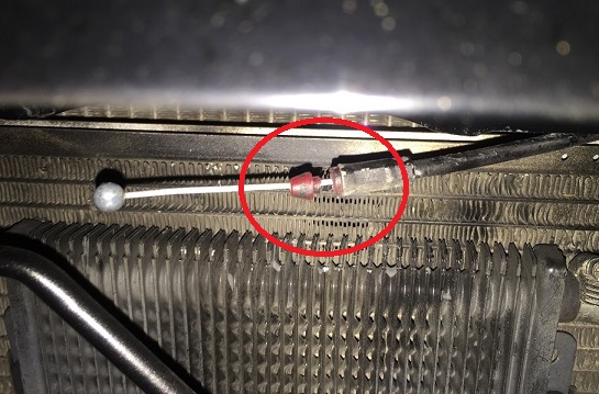

I broke the plastic piece that houses the end of the cable that locks into the hood latch assembly (the part under the hood). I thought about using some JB weld as my first fix attempt but in the event that it doesn't hold, I ordered a new cable as my back up plan. Will try to take a picture of the broken plastic piece to post later.

This is the end of the hood latch cable that clips into the latch assembly. Circled in red is the plastic piece I broke.

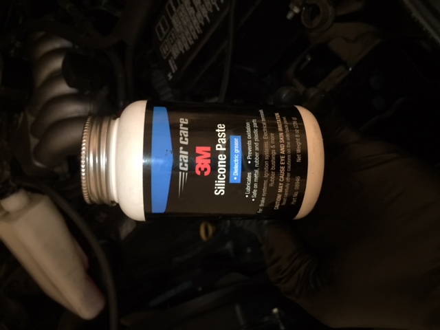

Humidity sucks man. Was planning on lightly lubing the cable with some silicone paste, should be safe on all the rubber and plastic components it will be running through right?

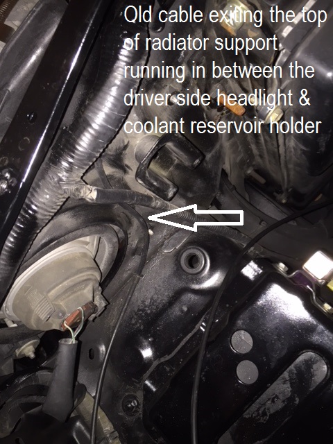

4. Remove the battery & coolant reservoir to gain access to the hood latch cable and make note of how it runs through the top portion of the radiator support > in between the coolant reservoir holder and drivers side headlight > in front of the battery tray> along the drivers side wall of the engine bay & through the firewall grommet.

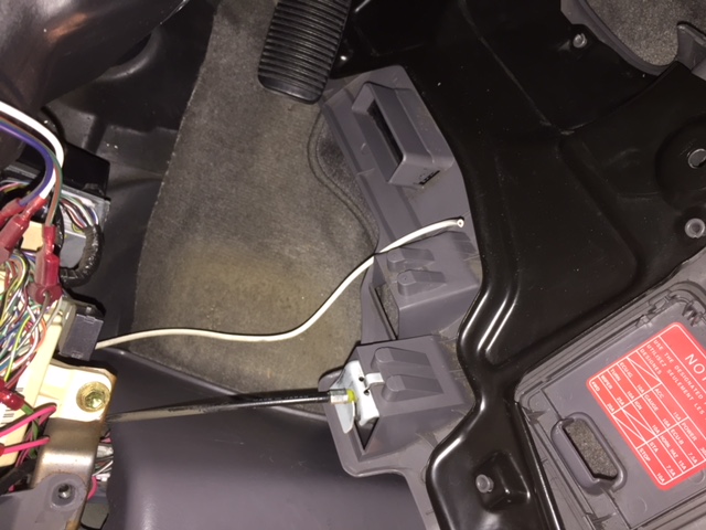

6. Remove the 4 10mm bolts holding the dash panel underneath the steering column.

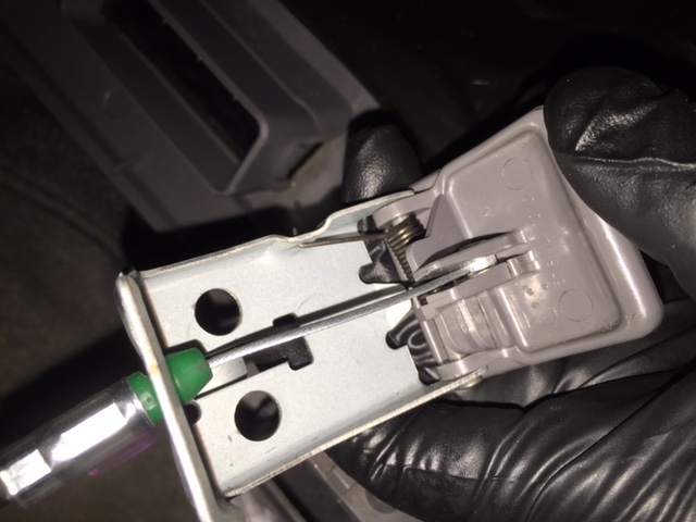

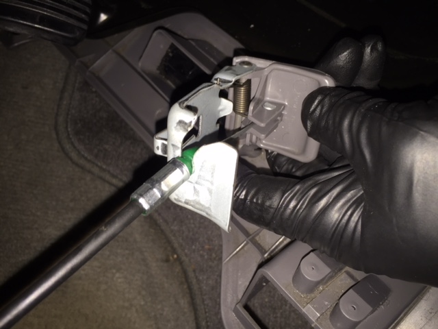

7. With the dash panel removed, remove the 2 phillips screws holding the hood latch cable lever to the dash panel. This will allow you to unclip the cable from the lever with less difficulty.

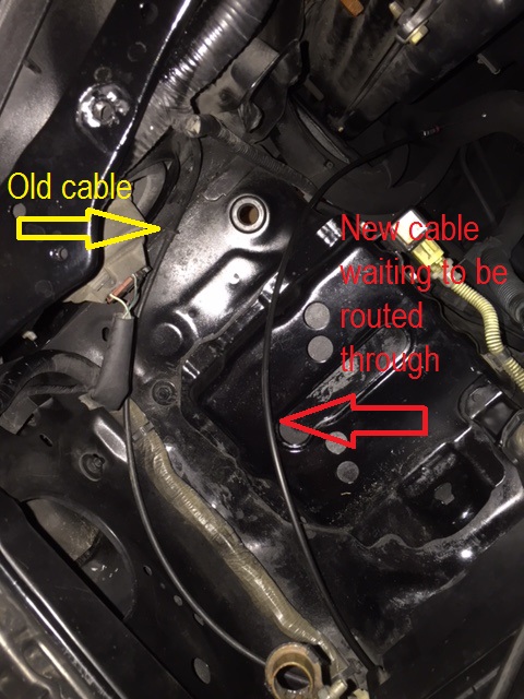

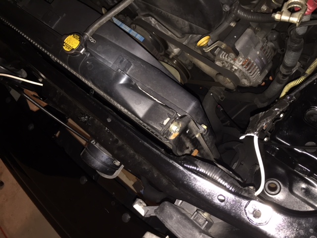

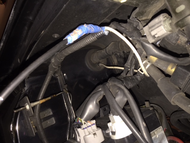

8. I taped a piece of an old extension cord wire to the end of the cable to pull it through the firewall. *Use duct tape & not painters tape so you don't pull the 2 pieces apart.
9. Here is a picture of the extension cord taped to the old cable after I pulled it through the firewall.
10. I detached the extension cord wire from the old cable then taped the new cable to the extension cord wire in order to pull the new cable through the firewall grommet.
11. I then ran the new cable along the path of the old cable as I was removing it.

3m silicone paste is excellent in its use.
Great stuff. Used a small amount to work into all my weather stripping so my doors wouldn't freeze shut and used a cotton swab to spread it along my window track so it wouldn't squeak rolling up my windows when it would rain.

Thanks for the write up. Much appreciated. The silicone paste was a good idea. I was going to use wheel bearing grease but the silicone is clear and not as messy.
